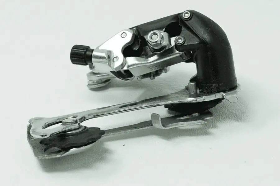

My son has been telling me his commuter bike rear gear change is ‘clunky’. It also doesn’t shift well down the block.
- We cleaned the drivetrain thoroughly, no change.
- We checked / adjusted the indexing, no change.
- We replaced the cable inner and outer, no change.
So, not telling him what it was, I swapped out his 200GS rear mech for an early noughties LX item. Instantly he said the gear change was better, less clunky and a lot quieter. Problem solved.
I’ve often wondered whether ‘upgrades’ half the time are only a perceived improvement, because we know it is LX/XT/XTR and therefore expect it to be better. Clearly though, there are differences.
In case you’re wondering why a 30 year old bottom of the range mech is still being used daily, my son bent the original Altus item (it is a modern bike). The only thing I had to hand to get him mobile was the 200GS mech. I then bought a mid-range 20 year old mech to replace it…. Cheapskate 🤣
200GS has an extra spring mechanism that shifts before the body of the mech moves, this, the 500/400/300LX mechs seemed to suffer from a bit of sluggishnes, even from new
It was dropped later

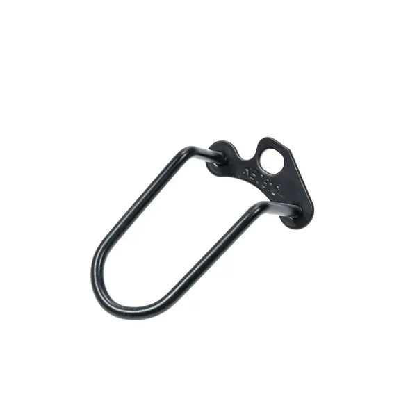

Recommended upgrade for any parents in this forum. Plus it is definitely retro. Both my kids have one on their bikes as they keep "parking" their bikes by throwing them to the floor on the derailleur side (even though both have a kickstand). Whenever they move to the next size, this protector follows them, until they can pay for their own lack of care...
