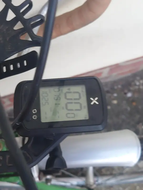

Last year I had done a 77 mile trip for the event so thought a 100 miles should be doable. Last year I had a tailwind and it was a moderate temperature. This year I had a slight head wind and it was 32 C. I had done some good training sessions so I should have been quicker than last year but the heat and headwind undid a lot of that extra speed. I really understand why a century is considered a landmark ride now.
