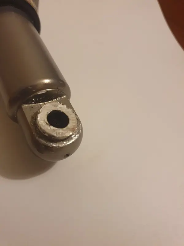

Attempting to build up a frame an I need to swap the shock an retain the old bushes
I can't get them out of the shock body I ve ran a hacksaw blade between the shock body an Bush to create an groove an tried to prise them
Tried turning them with vice grips an warmed it up with a heat gun
What happens if I warm up the shock with a butane torch ?
It's an air shock appears to be sealed no visible valve
Should I drill a hole in it first
Was thinking about cutting it but the part that the bushes go is solid I think
Will try to ad a pic
I think it just has two top hat spacers
One on either side
Some one has bodged them in there

They are split bushes an have I found the split between the two can get a very small flat blade screwdriver in it
Trouble is no amount of whacking is achieving anything they are still in there solid
I m happy to sacrifice the shock to get the bushes out if needed
I thought if I warmed it up enough the alloy would expand an I would be able to tap the bushes out however I think that aera is solid alloy so not sure it will work
