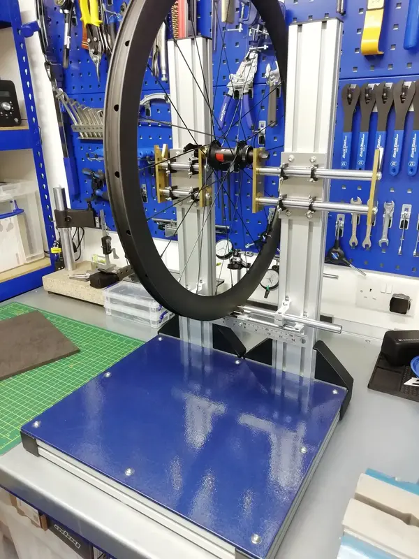

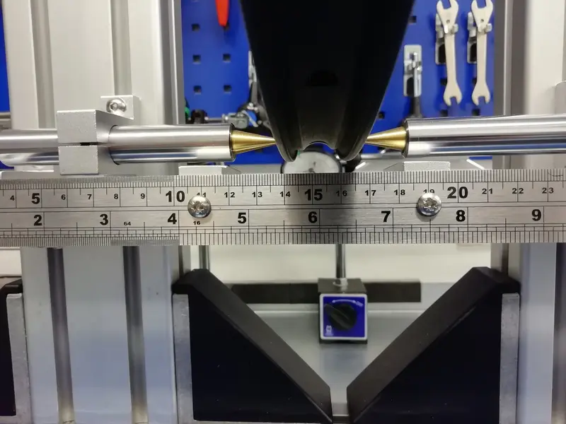

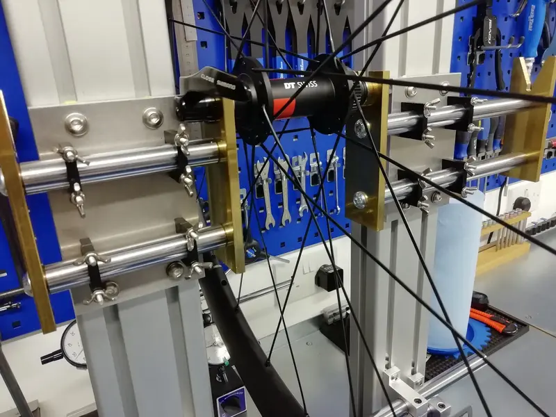

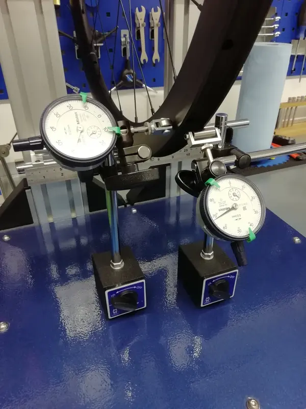

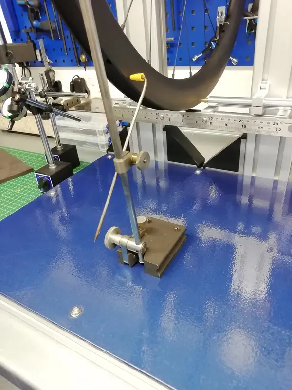

@Proto2000 @Frankenorange I've added a few more pics of the wheel jig. I tried to build something P&K Lie quality for Park Tool cost. As it turns out, I couldn't be happier with it. If I had another chance, I'd make a few cosmetic changes, but functionally can't think of any improvements. The design spec was...
1. Absolutely rock solid with zero flex
2. Flexibility to take anything from a BMX wheel up to a fat bike wheel - The plates provide the vertical movement. The rods provide the horizontal movement. It's quick and easy to adjust if you are starting a different sized rim.
3. Simplicity and ease of use - I built in an adjustable ruler and gauges to measure dish whilst in the jig. The original intent was just to get a rough idea of dish, but still remove the wheel to get ultra accurate with a dishing tool. As it turns out the ruler and gauges are just as good as the dishing tool.
4. Parts off the shelf, with no machining - The only parts requiring machining ended up being the brass brackets to hold the hub.
5. Steel base so I could use DTI gauges on magnetic bases.
I've got a parts list & loads more pics of me putting it together if you want to build one yourself.

Many thanks for all the comments, it really is nice to get a bit of feedback.
View attachment 592450View attachment 592451View attachment 592452View attachment 592453View attachment 592454View attachment 592455
Thank you for the extra pics. It looks the bees and a list of parts and dims would be much appreciated.
