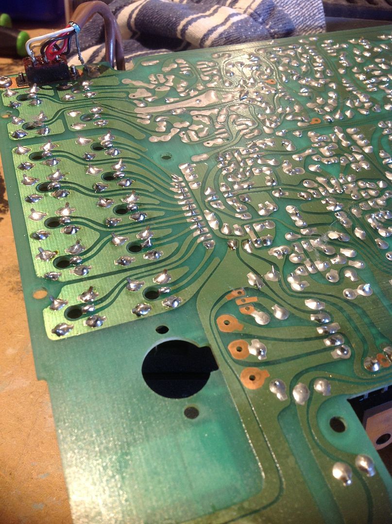

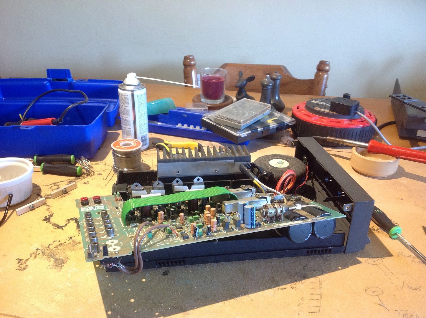

Nothing ventured. Kept losing channels on back panel
Note nice shiny solder on left. Went mad with the switch cleaner as well.
Could be me but it seems 2 notches louder with way more clarity. No hum from turntable. rather pleased.
Loving the 'made in Scotland' sticker on the transformer.
I know it's not a certainty but no bulging or leaking caps. Was pleasantly surprised. How had can it be to change a few? Recapping starts at £150 plus postage. Cyrus want more.
