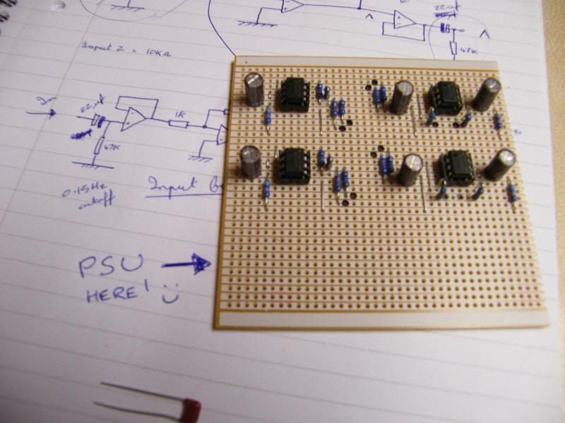

Tone Control under way
Just waiting for CPC to get their fingers out and send me the pots and capacitors for break frequencies, oh, and come up with a power supply design.
Initial measurements on the prototype tone control if anyone's interested. There is a small amount of HF instability (expected with this type of tone control) I can cure that but I don't have any low pF capacitors at home. Will have to grab a few in work tomorrow. Might shift the LF a bit lower, and the HF a bit higher, but will listen first. The HF roll-off is a 'feature' of the crappy soundcard in my measurement PC, and NOT the tone control circuit!
Flat
LF Max
LF Min
HF Max
HF Min
More difficult to make it battery powered. This needs split power rails, but fret ye not, I have a fairly radical plan :)
Brought home some low value caps to nail the HF stability issue so will do that this weekend. Also thinking about using fet input op-amps so I can dump the dc blocking caps (lower input offset voltage traded off against probably unnecessarily low noise)
Watch this space - It's gonna be good!
