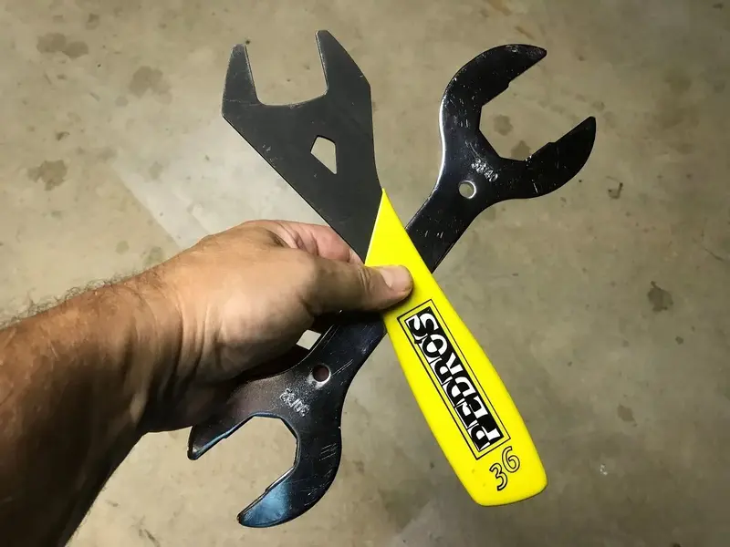

I misspoke, I meant two headset wrenches, not spanners.

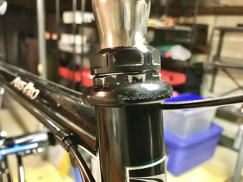

This is the Tioga Avenger headset, original to my Response Elite.

No cage up top; bottom is correct, I quadruple-checked.
