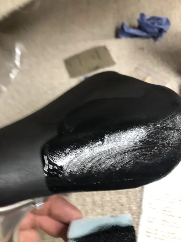

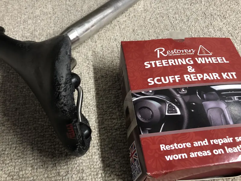

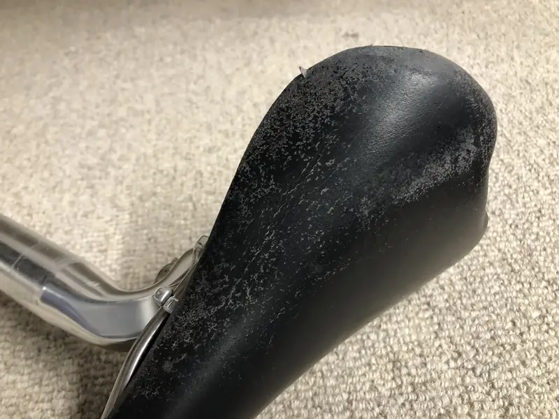

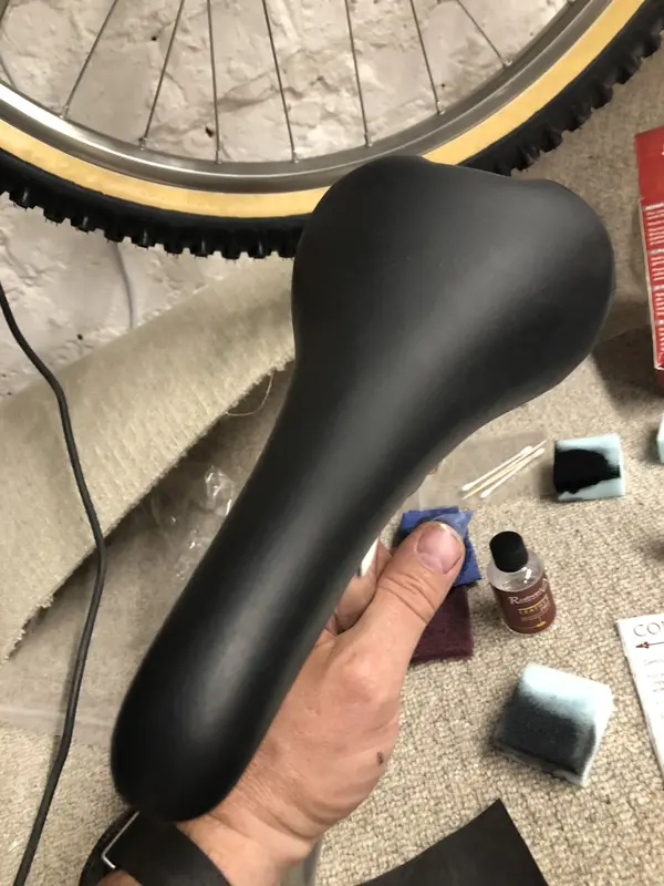

Got chatting to an old work colleague the other day, he’s into restoring cars… anyway we started comparing tricks & tips and he mentioned leather scuff & decolouration repair of leather steering wheels and seats, I mentioned that I’d struggled with getting a permanent fix of colour on leather bike saddles. He said this was childs play and that I should check out the Leather Repair Company in Hull and look at the kits for sale on their online shop; https://shop.leatherrepaircompany.com/
So, I checked out some youtube videos they had made and bought one of their kits for £25

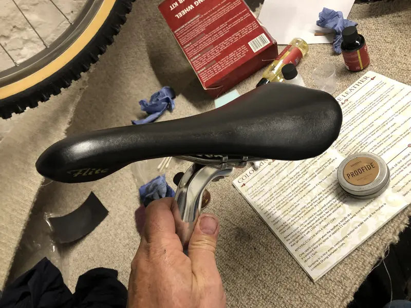

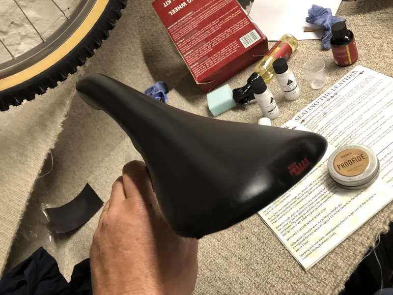

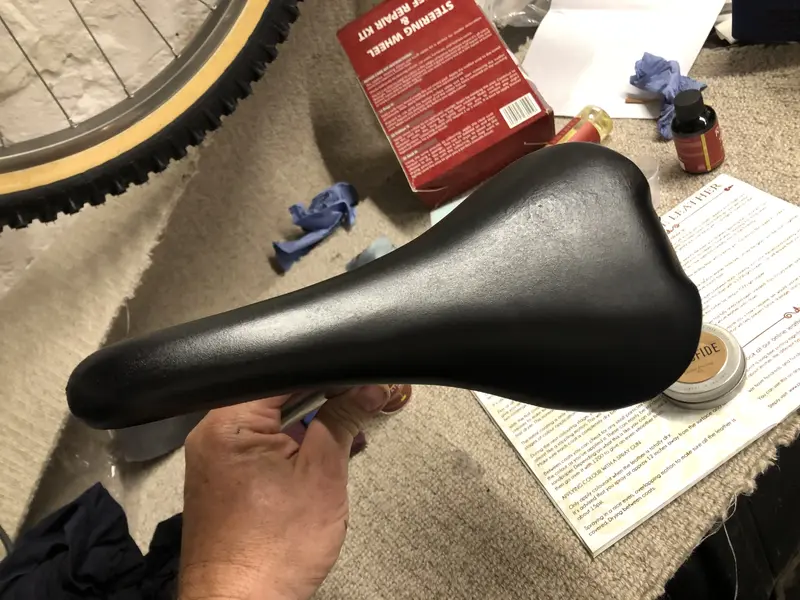

It arrived today…it took me exactly 20 minutes to turn a scuffed up old Flite into something considerably more presentable than it had been for many a year…
Kit comprised of;
• 100ml Premium Leather Cleaner..
• 1 x Main Base Leather Colour 50ml
• 3 x Tinters 5ml each ( sometimes more depending on the base colour)
• 1 x Leather Gloss Finish 30ml
• 1 x Leather Finish Matt 30ml
• 1 x Leather Prep 50ml
• 1 x Cotton Colour Of Your Choice To Repair Existing
• 1 x 30ml Mixing Cup
• 3 x Application Sponges
• 1 x Mixing Stick
• 2 x Tooth Picks
• 2 x Cotton Buds
• 1 x Sand Paper
• 1 x Detailed Instructions.
The instructions are pretty good however the youtube stuff is also very helpful.. but simply put,
Clean it
Scrub & prep the surface
Apply colour
Sand it with 1200
Apply colour
Seal it with the matt lacquer
Sand it with 1200
Seal it with a mix of gloss & matt to get satin finish
Then proofide it
I think there's enough product to sort at least 4 saddles.... :cool: IMG_6830.jpg IMG_6829.jpg IMG_6828.jpg IMG_6824.jpg IMG_6825.jpg IMG_6822.jpg IMG_6816.jpg IMG_6815.jpg

Thats pretty impressive, definitely going to be using this, thanks for the link :cool:
Re: OMG!! Leather saddle repair for dummies
That is good - I can see a lot of knackered old flites being snapped up on the bay and transformed

Cool. I've got a really nice grey flite with some minor abrasions I'd love to tidy. Anyone care to venture an opinion on what colour dye would match?
Re: Re:
That’s the beauty of these kits, they come with tints so that you can tweet the main colour. Check the website and give them a call (I guess on Monday) as I think they will sort out a kit for your own specific requirements.
