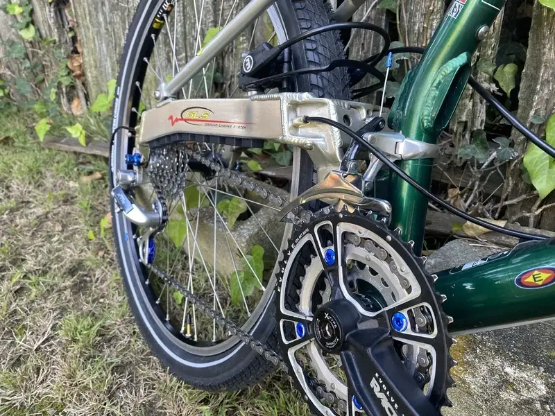

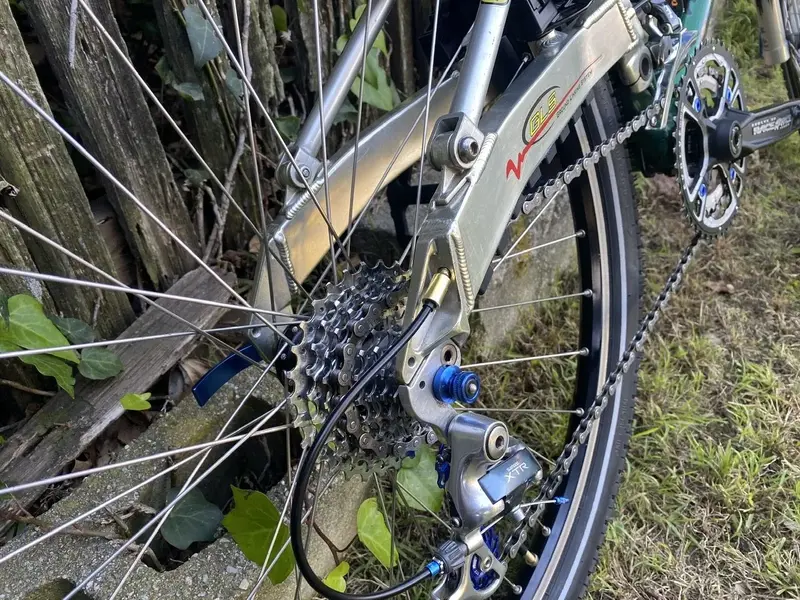

Yesterday and today more parts arrived - XTR derailleur, XT cassette, another Manitou 4 in fantastic condition (except for the elastomers), and a Beast frame in 9/10 condition with the fabulous non-pressurized oil damper. I now have 90% of the parts to build a new bike and leave the Animal untouched.
As it turns out, Proflex ferrules/step-downs/cable stops are quite difficult to find. Jagwire stops look perfect, but are 2mm too big to fit in Proflex’s open cable guides. I had to rob them off the Animal (who will get some Campagnolo ferrules in hopes of fitment). The ol’ girl is getting put together a little more every day. 66A8C897-6B0A-41F8-9C11-F4D596107975.jpeg
Almost there. I’m awaiting an Answer seat clamp and HG40 chain to complete the parts acquisition phase. At 225lbs, my greatest fear is that I’m too heavy to ride it, in which case my daughter will have a sweet new [old] bike. A57AC342-FD3A-4C55-B213-5CBFFE324AB2.jpeg 83CD67F8-AF31-4C4A-92D6-8AD005474C5F.jpeg 22EFF2DA-C965-46BF-949C-915402D23CB1.jpeg B5BB7105-BFAF-45D0-AD22-64CE4F4FF16E.jpeg
Well gents, here she is. The first stage of fine tuning is done. I’m gonna put on 20 miles tonight with my daughter and finish the fine adjustments.
