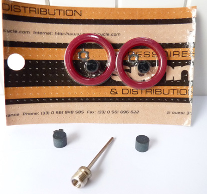

There's a star-shaped washer that holds them in place.
The one you see inside the red seal in the packaging in this picture
