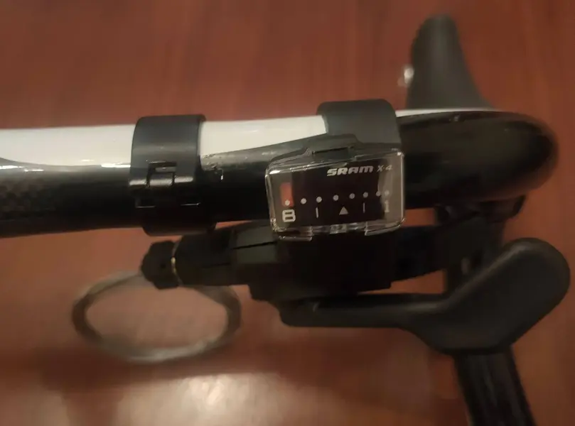

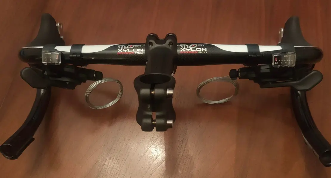

The reason for this is because the sti brake shifters didnt work well with V brakes so I wanted to use Tektro drop bar levers for V brakes which are great. The other option would have been bar end shifters but WHERE WOULD I PUT MY MIRROR ????? so removed the steel band from the clamp and they fit fine, I will give this set up a try, I reckon it will be fine 1.jpg 2.jpg 3.jpg 4.jpg 5.jpg
Difficult to operate gears and uncomfortable to operate cross-tops. This why you need super wide bars because you don't leave anywhere to put your hands, on regular width bars!
Why don't you just get bar end shifters? . They can be as cheap/expensive as you like and friction, index, or both.

I had one of those SARDAR bikes in a previous life, I think mine had Cantis but I might be wrong, I might have tried these if I had known they existed. I have fitted the setup in the photos to my Dawes Super Galaxy and it all works well, the shifters were cheap enough so I will see how I get on, I have given up on Cantis for sure, V brakes are far better, those Tektro drop levers for V brakes are really good btw
Seeing as you like 8 spd, surely you can pick up some second hand shimano claris STI shifters for not too much money, and then the shifters won't take up any handlebar real estate, or impact on your use of mirrors?
