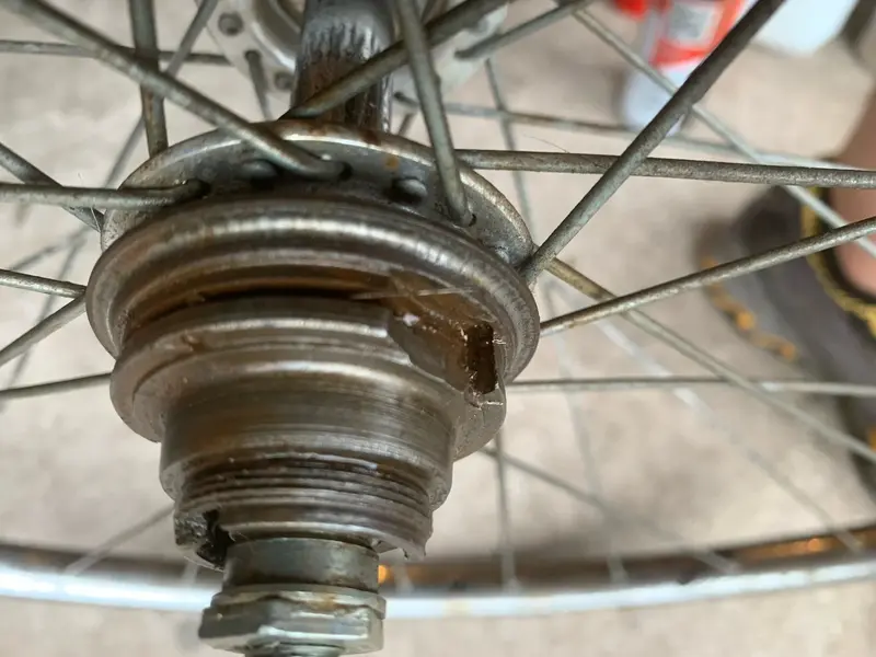

Simplex free hub springs - help needed
Having done thousands of these in the 1950/60s I can assure you that the pressure from a wheel nut or QR does help. apart from securing the removing tool.
Of course this does not apply to splined removers.
Thanks Keith. I've probably only done 100s in the 80's by comparison (when, funnily enough I worked with a Keith!). I was just interested in the engineering behind how pressure on the thread would help. If it is breaking any seizing between the threads, you'd achieve the same from a tap with a mallet prior to engaging the removal tool, without binding the threads together as would be achieved with the QR spindle. As I say, I'm not having a go, just interested in how this helps.
No seizing, just some 15 turns of thread which are very slightly released by the pressure.
