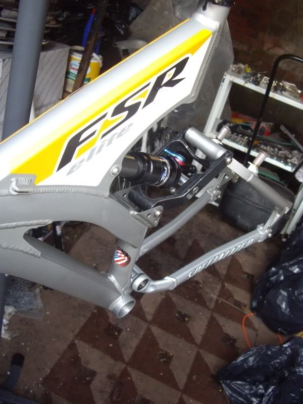

would i be able to add a shock with a longer eye to eye with this linkage on my FSR?
is anyone running a 'longer than 165mm eye to eye' shock on an original FSR link or uprated link as per my image above?
From my experience and research these frames came as standard with a variety of eye to eyes from 6" to 6.5". The later XC's came with 7".
So I doubt how critical a 165mm shock is. I suspect that within reasonable tolerances, the Stroke is what really matters. While Sag and i2i more directly control bb height?

I don't KNOW if 9.5" i2i is too much. But I THINK so. But just try, take a picture before and after the change to see changes in geometry. Then take a soft ride and report to us, we are curious ;)
I finally got aroung to measuring the i2i i've got mounted right now. It's 6.5 inches. There's no way a 9.5 would work. I might be able to get away with 7.5 i2i. Maybe 8? We'll see. I've got a good shock on it now; I'll only swap it if I find a killer deal.

I did pull off the spring on my rear shock and got more measurments. i2i is 6.5"; shock travel is a meer 1.5"; and rear travel measured at the rear axel is 5". I was hoping for more rear travel; but it is a 99' model bike. I'm pretty sure on big drops I'm bottoming out my rear.

Travel normally is 10cm/4". Tuning linkage come up to 12-13cm. And if you have a good damper, it feels quite modern and is definitely enough if you don't do downhill stuff. But that would also require modern disc brakes and no v-brakes ;) I don't think, you can bottom out a rear that is set-up well!
I just finished the upgrade to a BETD and one of the first DT swiss air dampers. Had a test ride yesterday in the backyard after 6 hours of turning new bolts, turning fitting screws, filing out the BETD. Felt like a curse, so much that did NOT fit...
edit: Now for some pictures. Still around 13,1 or 13,2kg. But now 130mm now front and back. And adjustable seat height.
edit: A german fella told me that this specific linkage has 144mm. Pew, that could explain the too sharp steerer angle!
As you can see, there is almost NO room between the damper and the linkage. Filing ahoy... This bike is full of constructional flaws: Seat post does not allow to lower the saddle. For installing a new damper you need kid's hands as there is no room for fingers, bushes AND the damper on the upper screwholes. And so on. But I love it.
