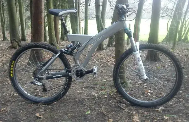

100-110 is probably the most travel recommended for these frames before it starts throwing the geometry out.
anything more and the angle would be too slack and handling would be affected/climbing would become more of a joke....
i've seen some with 120-130mm but you can see how slack it makes it, and some have upgraded rear links to counter this, but it then lits the BB height up more, which again would change the ride as it wasnt intended - unless you're talking a Sean Palmer frame of course ;) :twisted:
depends how you be riding it - XC? D-Hill? Free ride?! :p :shock:
It's a normal travel 98, I have a 2000 Rockhopper A1 comp turning up, going to make the long travel ride which I would like to 120mm travel forks and longer rear shock,
