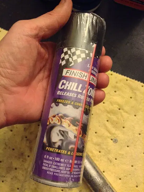

Well guys the foe is vanquished. I used Finish Line Chill Zone spray and after about 10 minutes of waiting and wrangling the post around with a wrench, it started to move a little bit, then more, then I was able to pull it out. It did not fall out on its own, it needed a little more conviction than that, but it wasn't very hard. So thank you all for your help. Much appreciated. Here is the product I used:
https://www.amazon.com/gp/product/B009V ... UTF8&psc=1

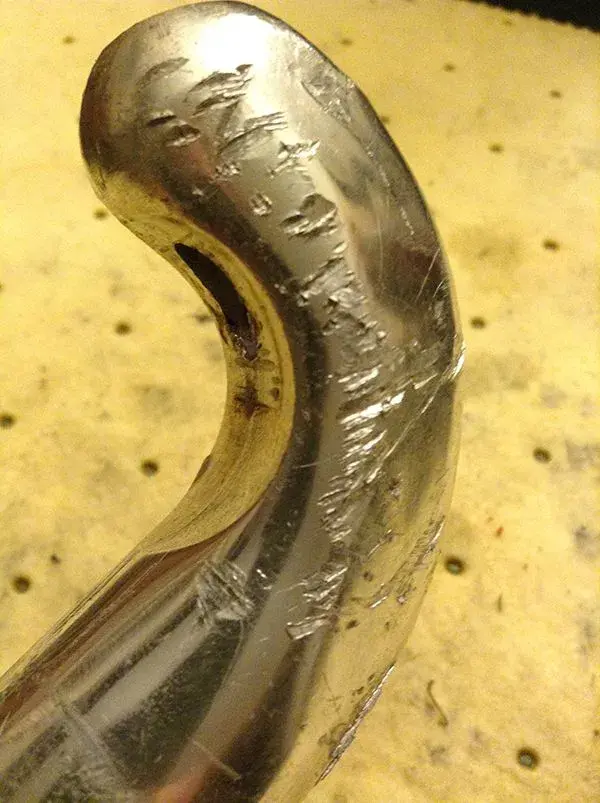

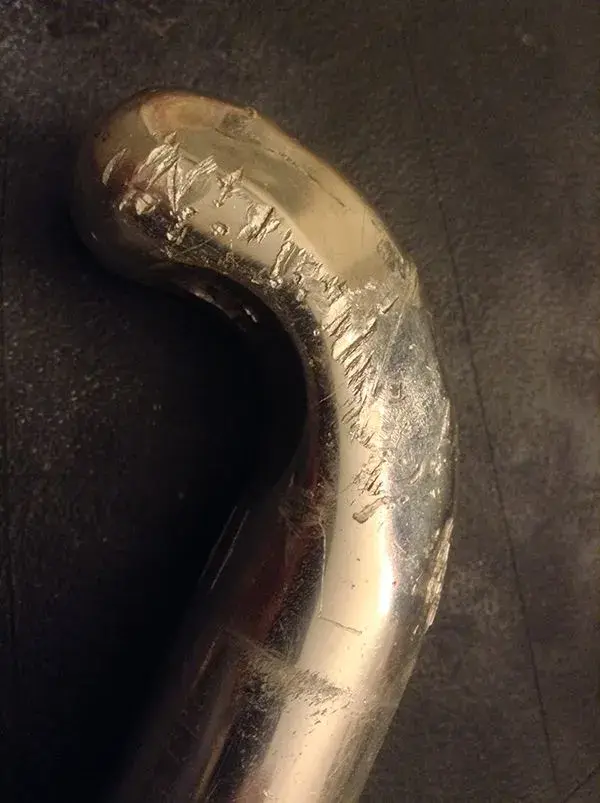

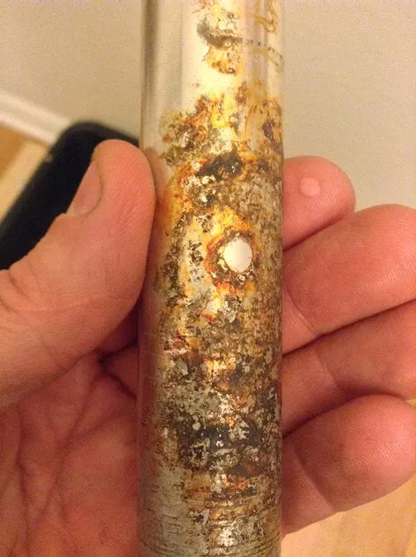

Here you go! Some battle scars and the secret weapon !

I thought you said it was a steel post :?: that looks like alloy to me.
Re: Re:
He changed his mind;
alainbriot":2kt2ny0o said:
It's an excellent suggestion unfortunately I live in the US... If you know of a similar service where I live let me know.
BTW the post is aluminum. My typing steel earlier on was a typo. I don't know what I was thinking.
