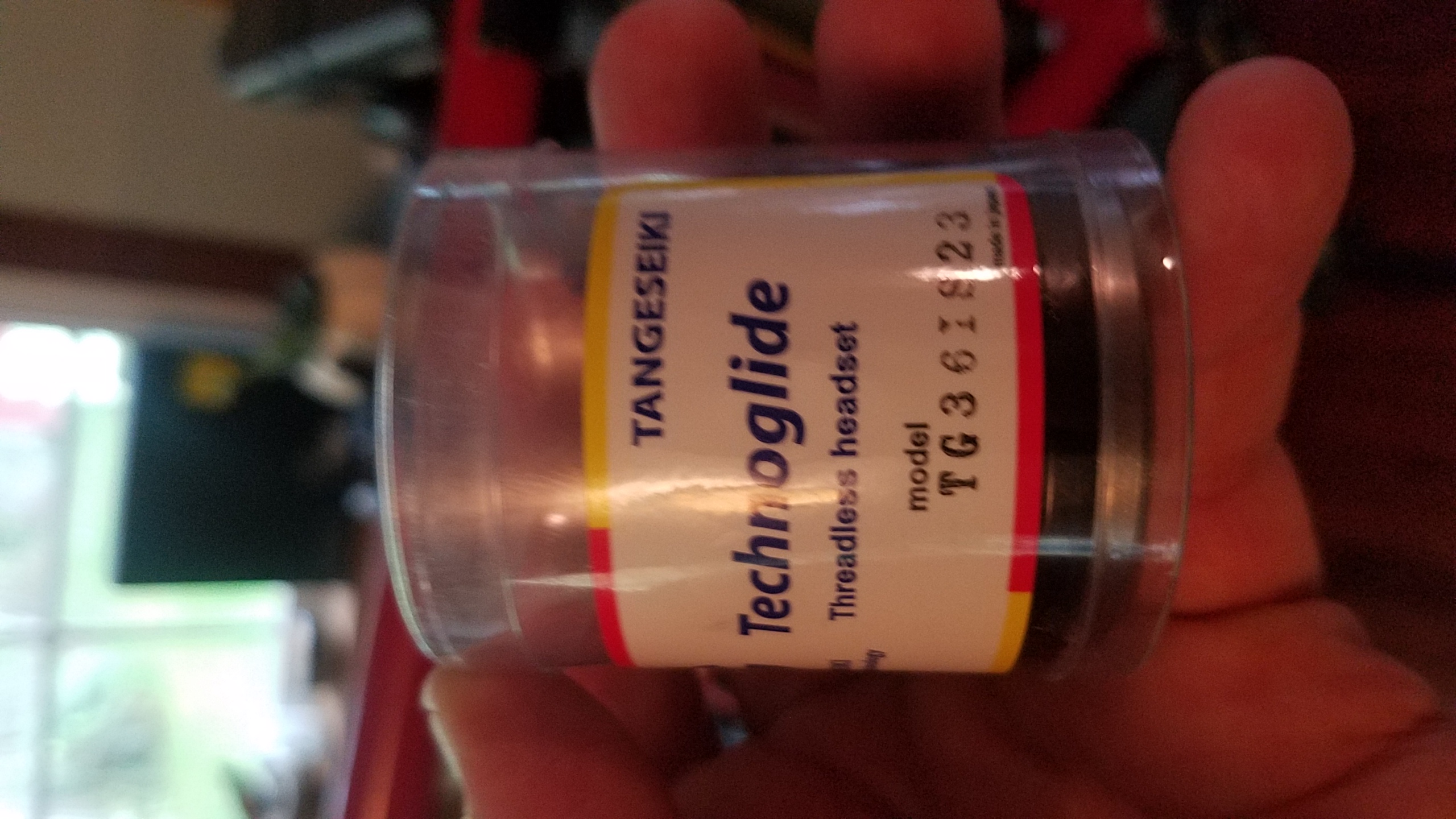

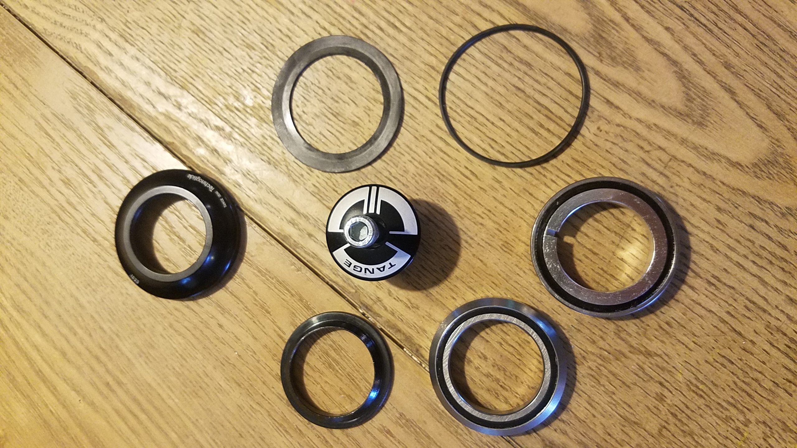

Alright, a very excited but measured update:
Today I got the polish headset (from woohoo)- see a few posts back for details. I ordered it online from their site and it rook 2.5 weeks to get. I won't be able to get the bottom race pressed until next week and I'm about to head out for a trip but from what I can tell it's exactly what's needed and looks like it'll do the job. I'll update again after getting the race set and assembly complete.
This is the packaging:
1JGCP
These are the contents (the star nit is there under the cap):
1JGCQ
Re: Possible Source??
1JGCP
1JGCQ
Update: I got the Chinese headset yesterday. It is a spot on match for the Polish headset from WooHoo (both have bearing exactly like those from Cane Creek). I have the Polish headset installed and it went swimmingly. Finished the build today and went for a shake-down ride with nothing falling off, all turns smooth, and the stem-fork connection tight as a well-tuned drum.
If you need an ICBM I advise contacting WooHoo and grabbing one up while they still exist.
