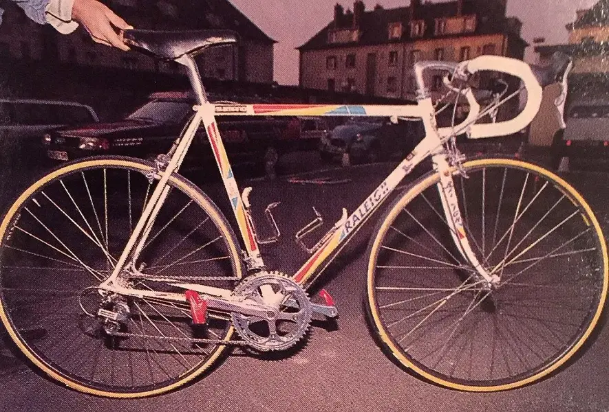

Hmm, so shall I put the black bars on or not ??? Mines not Fignons bike rather Jeans but I have built to Fignon spec...............
Re: Team Owned Raleigh 753 Dyna-Tech Castorama (Finished P7)
It depends. Are you building a Castorama bike or a Systeme U bike? It looks like you're going for the 90 Castorama team look so the silver would be correct. Besides, the real Bagot bike probably had Dura Ace STI anyway.
My frame is stamped 90
In 89 it was Super U and Campagnolo
In 90 it was Castorama and Campagnolo
In 91 was Castorama and Dura Ace sti
The only pics of the dyna tech in use that I can find are 89
Below I pulled a photo from June 1990 Winning magazine showing Fignon on the Dynatech. It's tough to see in the photo but under the magnifying glass the outline of the large head tube lug is visible. He also ditched the downtube shifter covers.
But your bike raises more questions than answers. First, Bagot raced on R.M.O in 1990 and was not on Castorama until 1991. So the question is, why was a Systeme U/Castorama Raleigh built for him in 1990? The second photo is going to cloudy the waters even further. I pulled it from the July 1990 Winning magazine. Here you have a 1990 bike in Systeme U/Castorama livery but with Shimano STI! Plus, the magazine describes the bike as Philipe Louviot's bike. The same Philip Louviot that raced for Team Z/Peugot in 89 and Toshiba in 90 NOT Systeme U or Castorama. That bike should not be seen with STI until 1991. So why is Louviot riding a Systeme U/Castorama bike?!
Here is my theory. Perhaps in the 1990 Worlds, some French riders were given Raleigh's with Castorama paint job to race. Perhaps Bagot rode your bike in the 90 Worlds. I cannot think of any other explanation.
Indeed, more questions .........
I did think that my self that either they gave him my bike in 90 to practise on and get use to before racing for the team in 91. Or that it was made in 90 but not used until 91.
