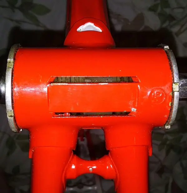

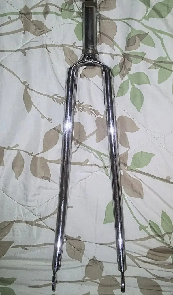

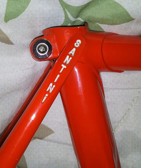

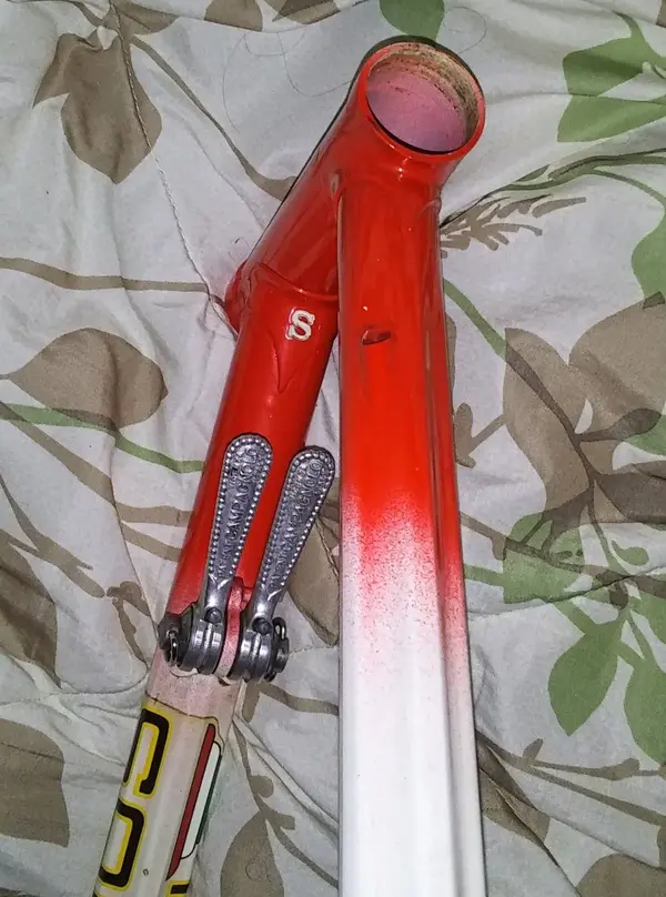

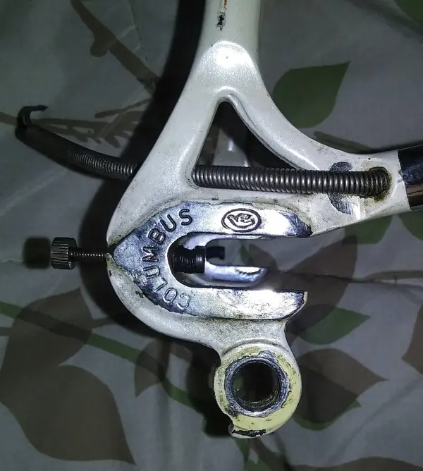

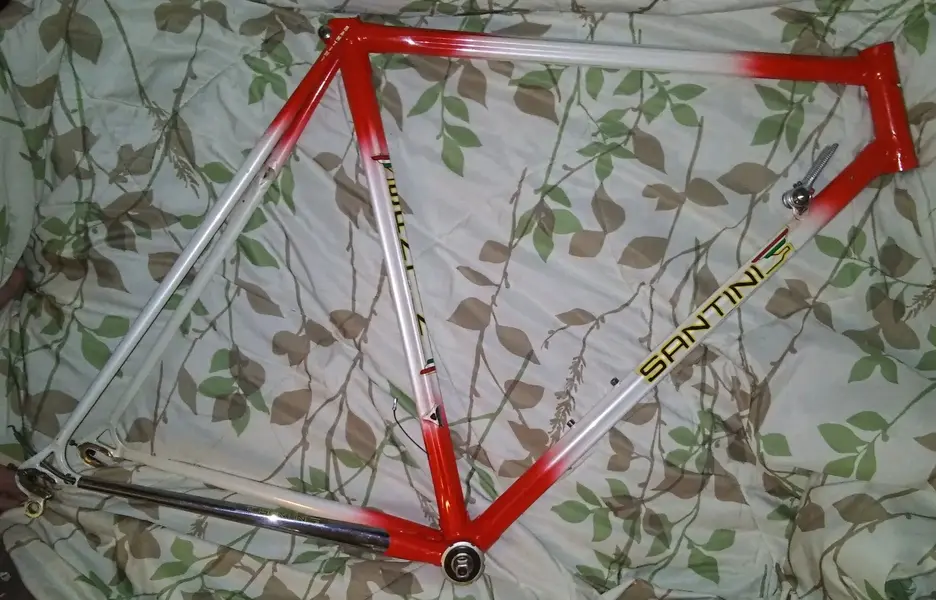

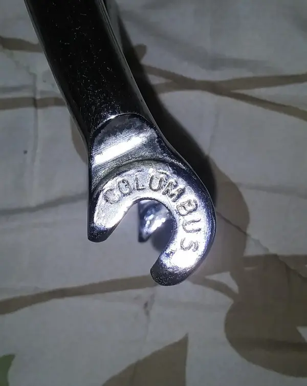

Here is another 5 flute frame similar to the Gilco 4 flute style frame. I cannot verify that it is Columbus tubing, but rear drop-outs are Columbus and fork is fully Columbus (steerer, blades, and drop-outs).
Based on features I believe it is from late 80s before Colmbus decal style change (unless old stock decals were used), and rear spacing.

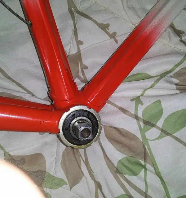

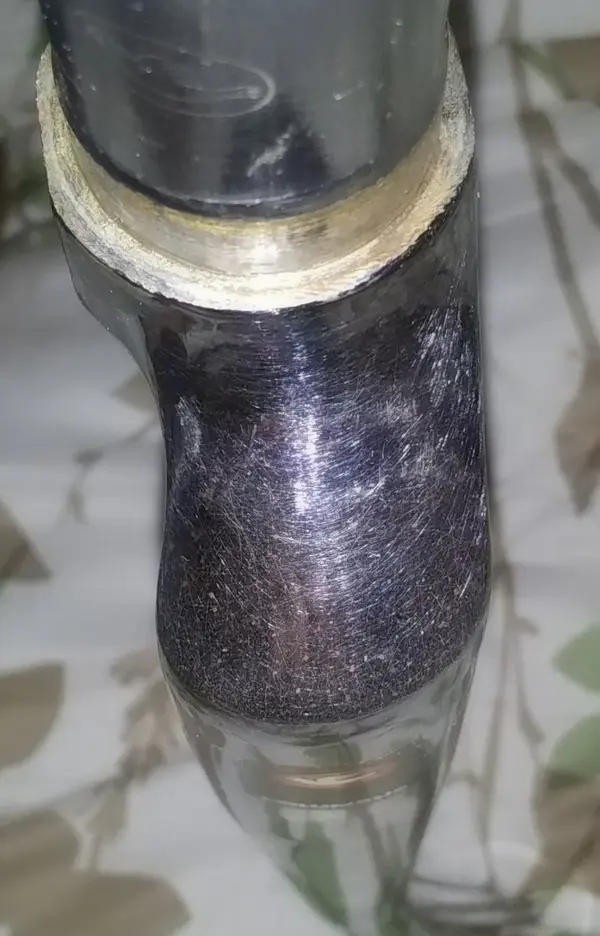

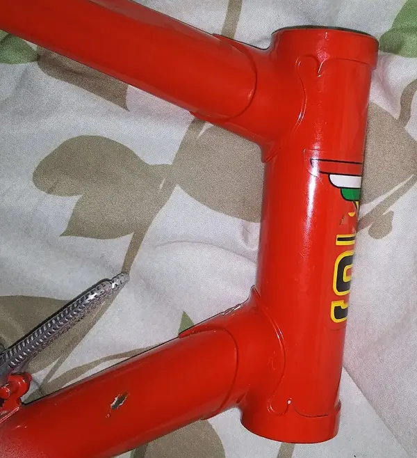

This does not match frames from the Santini marque based out of Forte dei Marmi Italy which has a 4 leaf clover logo instead of the bird's head logo featured on this frame. Quality of conjunctions is very good without gaps or excess solder which is amazing around the BB shell due to non-round tubing mating with round BB shell DT and ST nozzles.

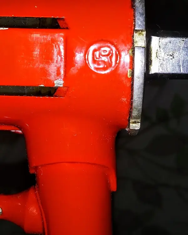

"SR" mark (not Sakae Ringyo) cast into BB shell, Italian BB threads/70mm, internal shift and brake cables, 125mm rear spacing. 20230921_033725~2.jpg
20230921_035452~2.jpg 20230921_033928~2.jpg 20230921_034124~2.jpg 20230921_033522~2.jpg 20230921_033258~2.jpg 20230921_033355~2.jpg 20230921_032917~2.jpg 20230921_033020~2.jpg 20230922_024500~2.jpg
Thanks for the link @vcballbat The suggestion of San Remo being a possibility seems plausible; at least it is in Italy. I had seen the mark on a Raleigh as referenced by another individual who also contacted Columbus (I guess due to the seat post tie-in), but he said no reply was ever received. Obviously, it was used fairly widely by some top builders (i.e. Losa, Chesini, et al.) for a short time period (mid to late 80s to early-mid 90s). I am going to check some of my other frames to see if I have more examples of this BB shell. I have not come across any other components with that mark.
