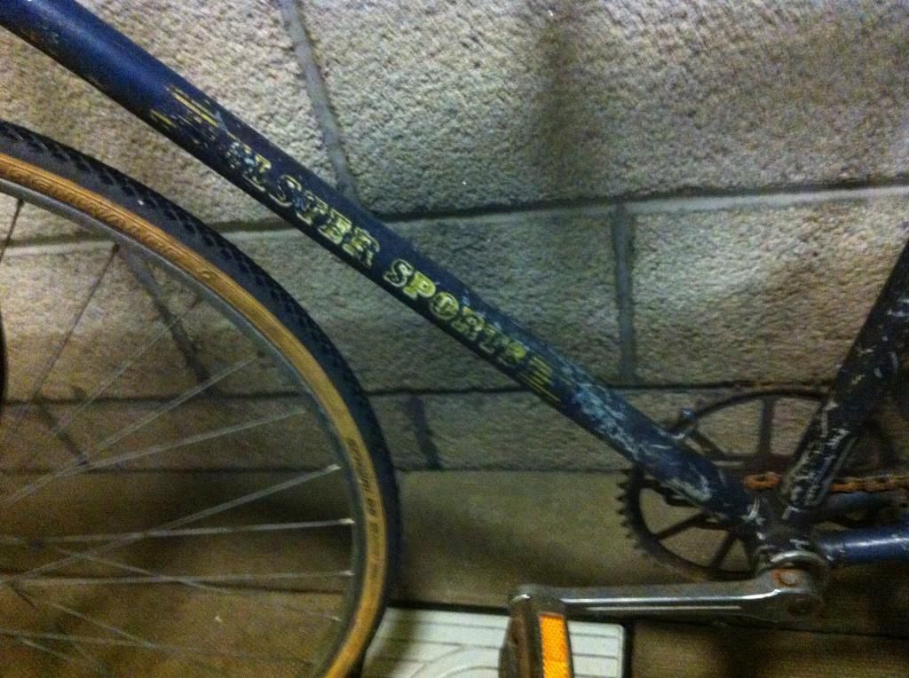

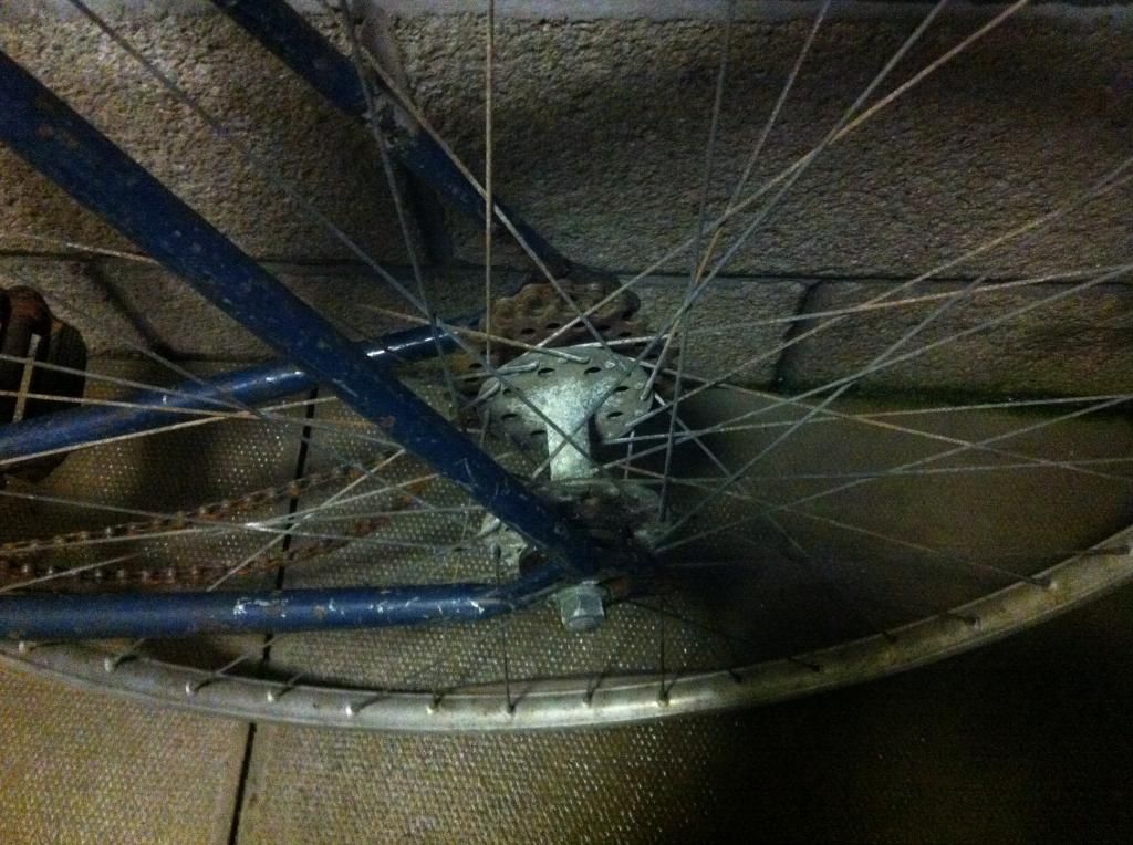

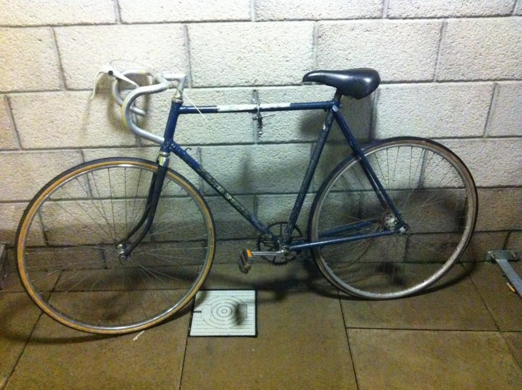

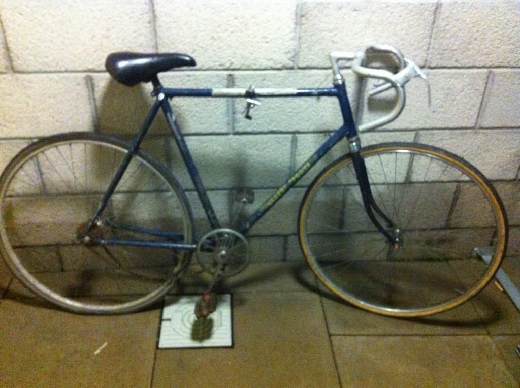

Hi everyone, I picked up this old beauty last week from my local bike workshop. It is a Rudge Ulster Sports bicycle, I have looked on the web and wikipedia says that Rudge Whitworth are defunct as of 1939, somewhere else I saw something about a 1952 Rudge catalogue, so I have no idea how old this is :/ could someone enlighten me please? Can someone please tell me a bit about these bikes, their history etc and what a complete/good condition one should look like. I am as yet undecided about what to do with this bike, the previous owner tried to make it into a fixie as the cassette is seized, I want to convert to hub gears, I have a spare 3 speed hub as well as a 5 speed hub kicking around. I am thinking of doing a sort of rat/restomod thing here, keeping the frame forks and crankset original, going for some tasteful modern components, hub gears, shorty mudguards, brown bar tape and saddle etc, a bit like what the guy in this video did with a Raleigh Lenton sports https://www.youtube.com/watch?v=lzC4JZ2yMkw
Anyway, here are some pictures, better pics to follow soon :)

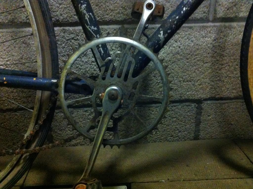

wicked ha that crank! the hand,do you think it is the red hand of the ulster men ? i thought rudge were birmingham way ?i must find out more.

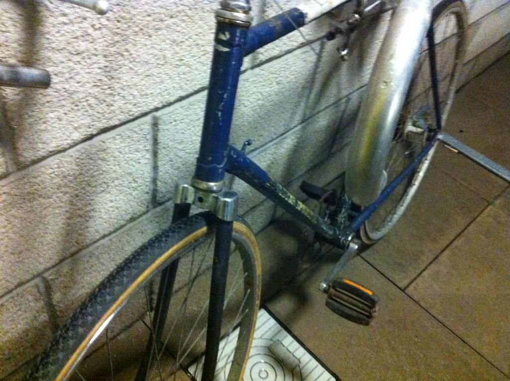

there was a chat here recently about them being taken over by raleigh.i really like the chrome fork crown cap .i wonder if the slight bend of the down tube near the h tube is typical or an optical illusion.
cause im sure that sportsman frame shared it.[great film,i would have lug lined and box lined gold & deff snipped off the top of the m guard stays]
and a shame they lost the reg harris and 531 sticker]

That's well post-war. Mid-late fifties, I'd imagine. As discussed, Raleigh took them over and for many years produced badge-engineered versions of their own bikes.
The Rudge crank's probably one of my favourite bike components of all time. Forget your CNC nonsense, cotterless cranks really were art.
I've got a 1951 Raleigh Lenton. It's got modern, box section rims and a modern 3-speed hub, as well as dual-pivot brakes. You really need to switch to 700c, you won't find decent rims or tyres in 27 x 1 1/4" anymore.
Shorty mudguards are best left in the past, I feel. A pair of Bluemels Lightweights would look good, and they were made in the same shade of blue. As to bar tape, I would suggest cloth. Although it would probably have originally had grips at the end of the drops, like mine:

you need to correct to cotter'd :p
what are the num' of teeth on that crank please.
Most 3-speed hubs manage 30,000 miles without maintenance.
On the other hand, 4 speed hubs are terribe. Get used to a lot of neutral gears with your 4-speed. They're collectors pieces nowadays.
Of course, if you want to keep the look and the 40h shell, you could always transplant a 3 speed gear into a 4 speed shell. No one would know....

i wonder if the two head lugs are identicle and because the down tube is coming in
at a slightly different angle to the angle of the lug,that is why it looks slightly bent.
You have a low end standard Raleigh from probably mid 1950s.
Beware of non-standard 26 threads per inch forks and bottom bracket.
