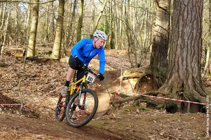

Good looking bike you've built up , can't wait to see it in the flesh ;)

Absolutely stunning. One of the best modern / retro bikes I've seen.
Can you put up the full component list for the build? Trying to something similar on a slightly less wonderful frame :)

I plan to use it at the first round of the Gorrick race series in a few weeks time.
The 42 / 28 double works really well with the 36 / 11 cassette for my riding. The 42 spins out a bit on the road bit other than that it's perfect. In a lot of xc races you only need to stay in the 42 tooth chainring for the whole race as the cassette has such a wide range, so less chance of missed shifts and chainsuck etc
