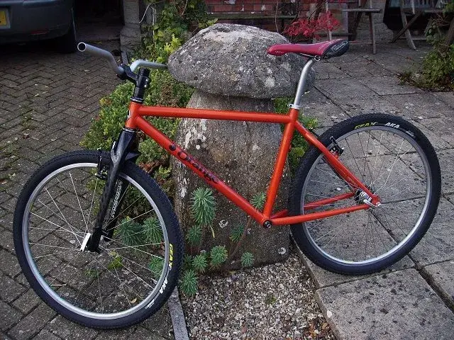

Have you fitted the forks and ridden the bike?
If not, I suggest you stack it up with some spacers, above and below the stem as necessary try it out for a few rides, maybe swap some spacers around try it again and basically make sure your absolutely certain you want to shorten the steerer before you set about it with a hacksaw. :D
Agreed, but I do think this looks a tad ridiculous TBH..... :facepalm: :LOL:
Yep, use a fine blade as you get in junior hacksaw.
If you have a pipe cutter use that to scribe a mark as a guide.
Thanks chaps, that's really useful. Big breakfast then going to give this a go this morning I think....probably.... :facepalm:
A damp cloth to hand helps with keeping the dust damped down. It's not very nice stuff.
