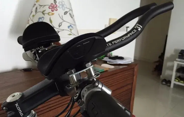

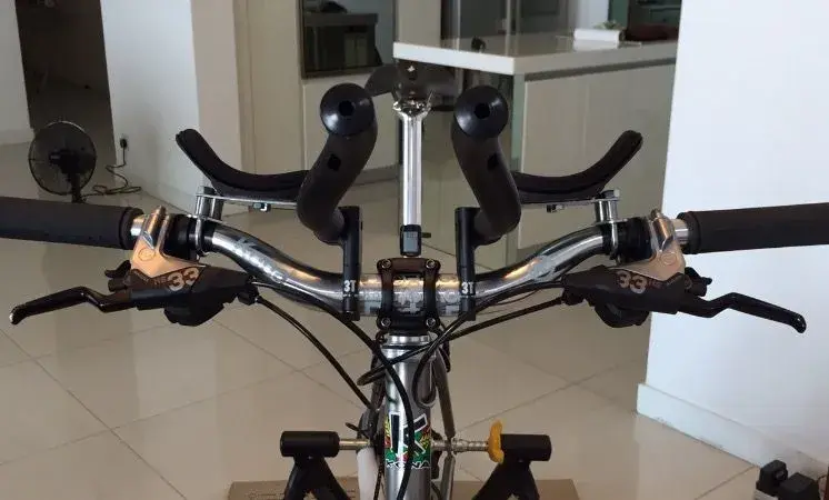

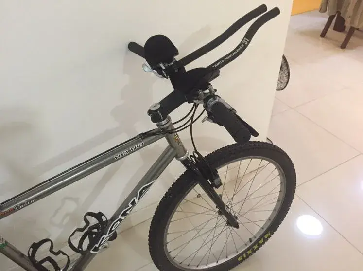

Now updating to second contraption..
Wrist now strong enough to ride but aches after a while, solution: MTB TT bike!
Fitted a set of Tri-bars. It took a bit of fettling but works well. Clamps are 31.8mm so had to fit them close to the stem due to the design of MTB riser bar, needed to lash up some brackets to space the elbow pads apart. Also needed to remove the XT shifter indicators to create space for everything on the bar so made some weather seals out of a clear plastic iphone cover to keep the shifters clean.
Just came back from first ride (road) and found it quite an interesting experience riding on tri-bars. The first noticable difference is the very twitchy handling, it takes a while to get used to it, and secondly the aero effect, i was using higher gears and rolling faster than previously, to an extent greater than i was expecting.
