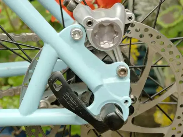

As far as I know you will need a new rear hub, you can get frame adaptors from A2Z components, but not hub adaptors.
Those adaptors are fairly fussy about what frames they will fit - they need a large flat dropout face, which rules out fitting them on any steel frame (presumably yours is aluminium though ?).
On the other hand, it's a fairly simple job to retrofit a caliper mount to a steel frame if you can braze (or know someone who can).

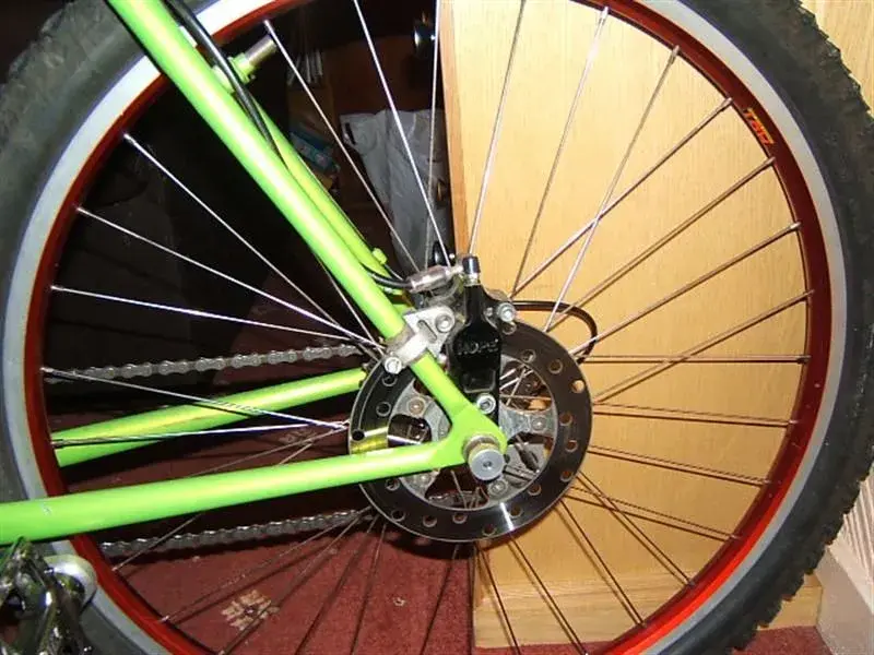

My last disc add on was for a 99 clockwork ,using the hope-ti glide set up,hope have a caliper that partly mounts on the hub drop out and the seat stay,my attachment for the stay was a jubilee clip,it ran for about 9 years till i sold it to some guy in France,no problems ,been at 35mph then slammed on both f+b,again no probs
I dont think they had discs in mind for the 99 clocky
Just found a pic of it-

God that looks f**kin amazing on that bike ,even though its discs they do look very retro
Very retro indeed
The mark 2 however looks poo [although] it is old and tatty
But the mark 1 ,now thats cool :cool: ,and the rotor is perfect

Will buy the a 2 z and see what its like.
I have wheels etc. was planning on a rigid carbon fork, post stem and bars. Not to bothered about the whole retro look but will see how it turns out.
The frame is aluminium so braze ons are out.
