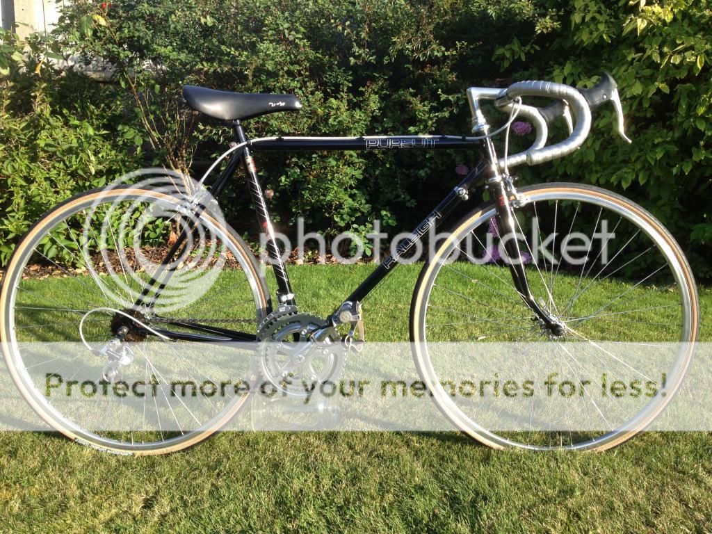

Raleigh Pursuit 30 years later. Finished pics on page 2
Thank you Dave
It may 'only' be a 'gas pipe' but it's my gas pipe
(well, actually it's MrsW's, as it's too small for me!)
I see too many of these chucked in the metal skip at the local tip.
Yes, I have spent lots of time, effort and probably too much money, but I think it's worth it
Yes I have spent way way more than my bike is worth, but I love it, still altering "the settings" on the bars and seat seeing which position/height/tilt is most comfortable to ride, it's such a pleasure to ride, I'm getting used to the 30/42/52 road triple gearing a bit now having been spoilt on 22/32/44 & 11/34 MTB gearing for so many years it was a real shocker when I first got the Kellogg's with 42/52 14/24 how the hell do you people get up the hills on those gears lol
Well Done on the Pursuit build, A fine looking bike worthy of saving.
Still some 'fettling' to be done yet me thinks...
Need to 'treat' it to a half decent alloy chain set (period ish correct) and an alloy seat post (the one I got from you is for a 501 frame so is too big! :-( )
It's been on a 'diet' whilst being restored, and I've tried to lose everything made from steel, including the original wheels which weigh a tonne!!
Updated
Had problems with rear wheel coming adrift when pedalling hard, so had to straighten out the drop outs.
Changed the gear shifters for period Raleigh black resin ones, and added a Selle Italia Turbo.
Need to sort a new seat post, but found the one now on the bike in the garage!
"Saddle - Need to recover" ..

I never got around to recovering the saddle..
I did, however buy 2 NOS Selle Royal Dolphin's on the understanding they were black, but they turned out to be Shark Grey!
For now, it has the repro Turbo on it, maybe one day I'll recover the old one!

I have to say I dislike color of hb tape and the rest of the bike deserves for the tape to be little better applied; more even :)
Sorry to dredge this thread , cracking bike btw!
Is the tange bb the original? Im restoring a Raleigh Banana that has the exact same cranks but the bb is shot, just wondering if you know the length. The original is 123-124 but wondering if I can get away with somethng shorter, bbs that long are hard to come by !
cheers
