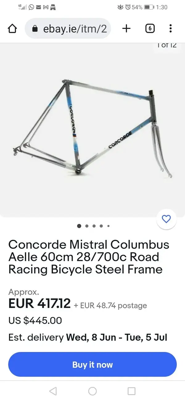

I've been searching quite a lot, seems like 59cm top tube frames are very few. I searched through 75 pages on ebay and found two 59cm TT that were at the limit of my budget, (including postage), see below.
Are there any good sites for buying vintage frames? I've searched through the for sale section on this site but nothing so far.

I'd have thought a dedicated saved search on eBay will throw up a suitable frameset (Mercian or other) within a couple of weeks.
