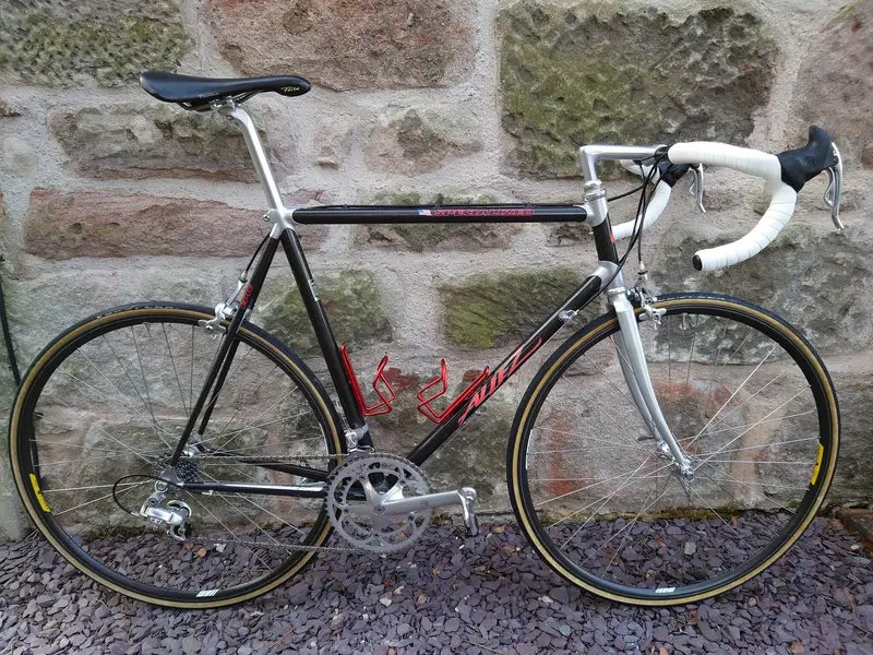

I've got a 1990 Mercian Professional that is too short for me in length, (TT 56cm c-c), stem is 110mm in length from centre of steerer bolt to centre of bars. I've been looking at buying a frame that is longer, (TT 59/60 c-c). I'm now wondering if I installed a quill stem that is 130/140mm or so, would that make up the difference? If anyone has any experience with long reach stems or knows of any particular ones I would be grateful for your help and advice. Thanks

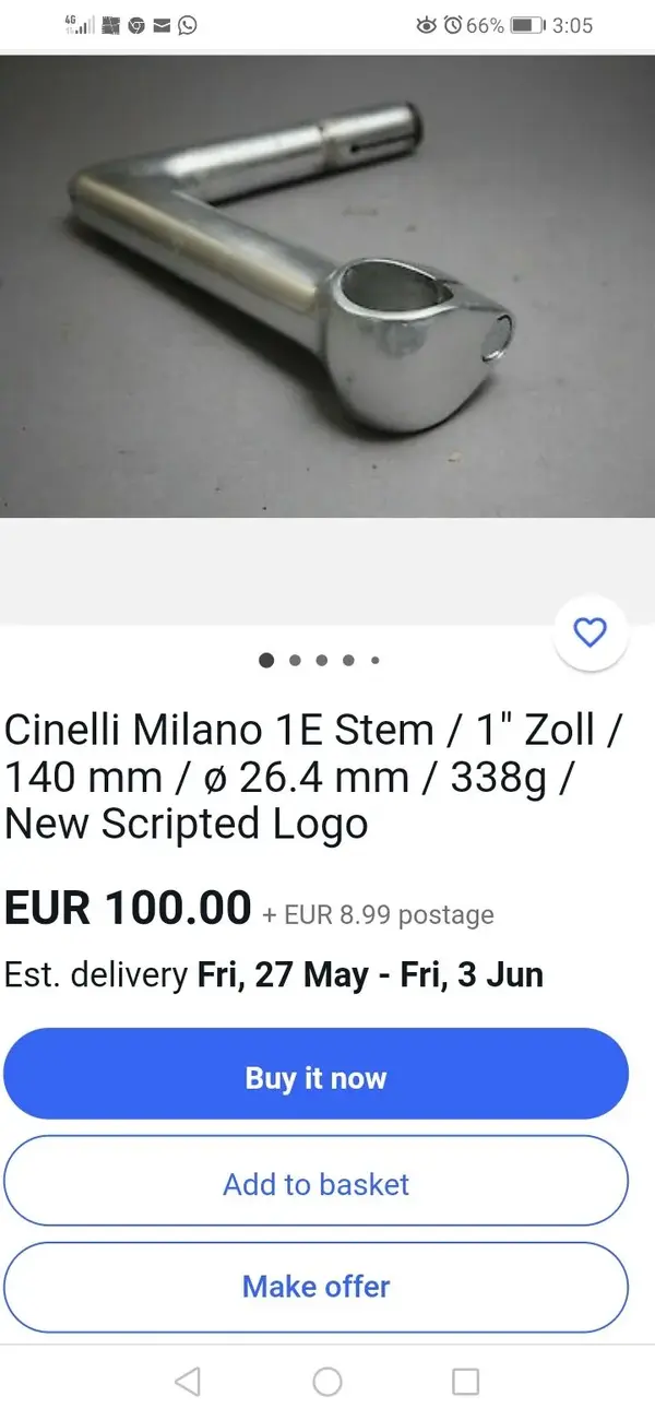

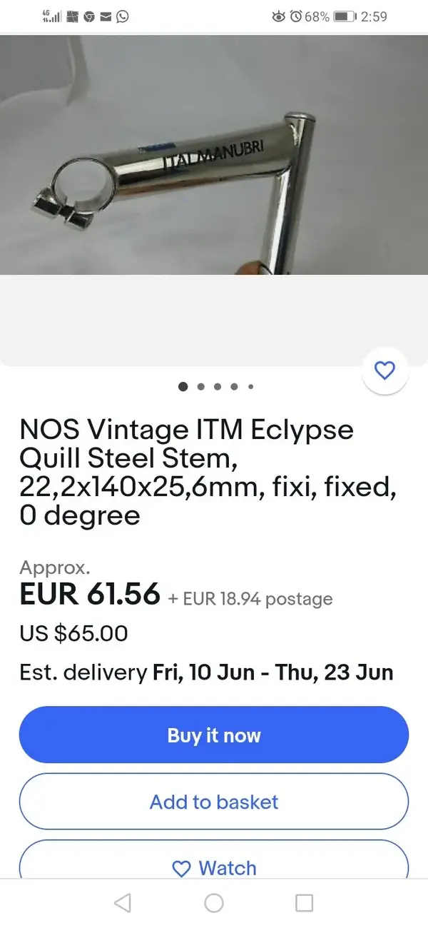

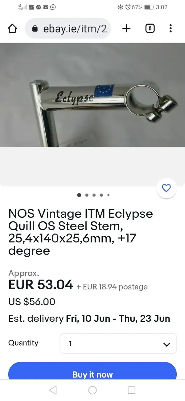

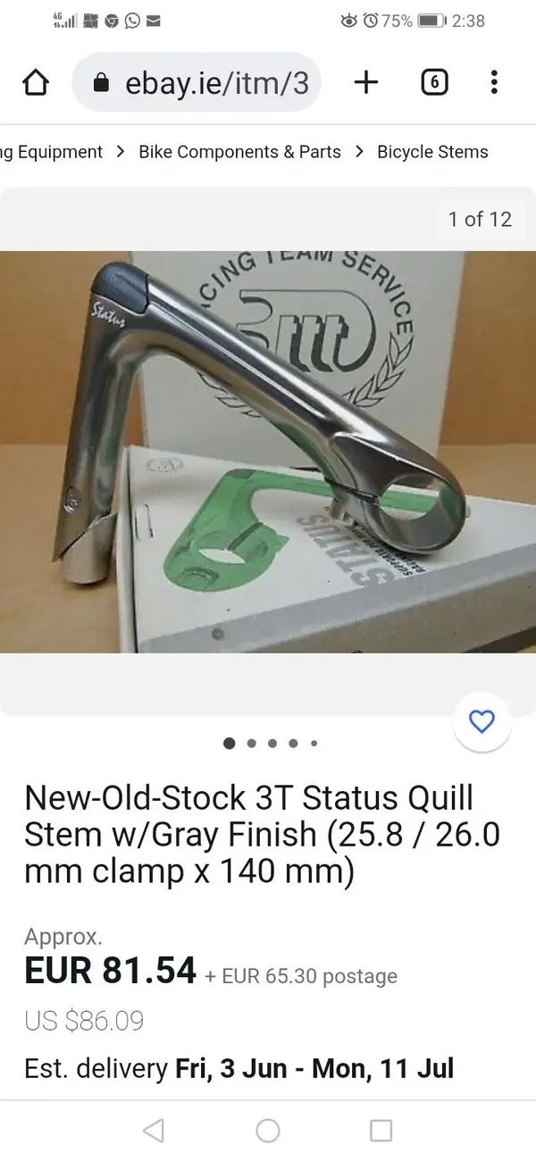

I've found a couple more, if anyone has any thoughts on them I'd love to hear your opinion. The ITM stem is +17°, would that mean a slight raise on the bars?

Mirror your saddle position relative to the bottom bracket from your Raleigh to the Mercian and then that will determine the additional reach and height you'll need to adjust for with a stem for the Mercian. I once tried a smaller frame but it was the height difference that scuppered that idea rather than the reach.
All the measuring I've been doing and never thought to compare the bikes side by side. I'll definitely try that, thanks for the tip.
