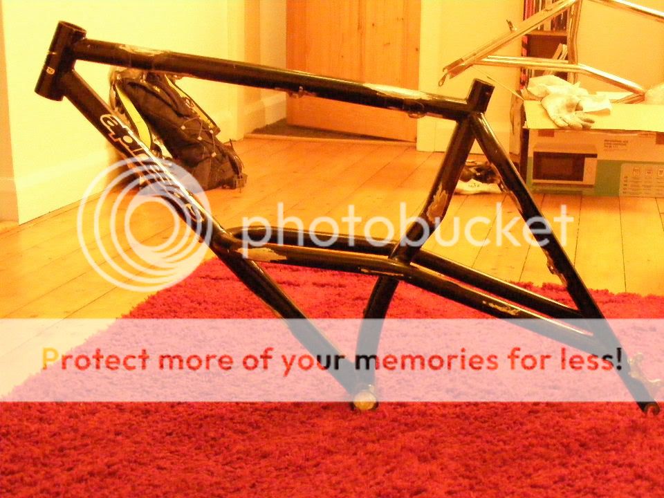

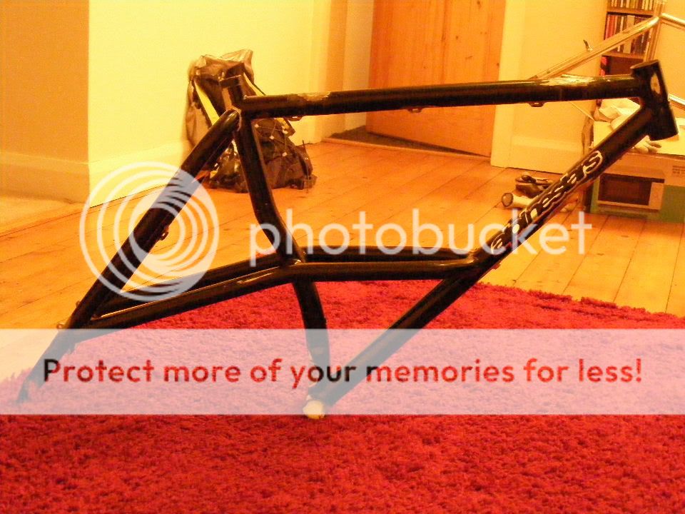

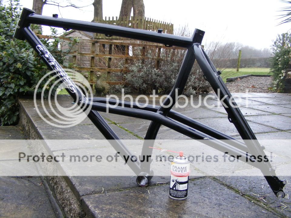

I’ve been plodding along getting this frame ready for paint recently and finally it is ready to go to the powder coaters.
A few weeks back I gave the frame a treat by applying a large dose of frame saver to it. This should have done it’s magic by now and treated any rust inside the steel tubes. However, having frame saver in the tubes would have a bad effect on the powder coat when applied, so the frame is being chemically dipped prior to coating. This should remove all trace of the frame saver and thus have no impact on the finish.

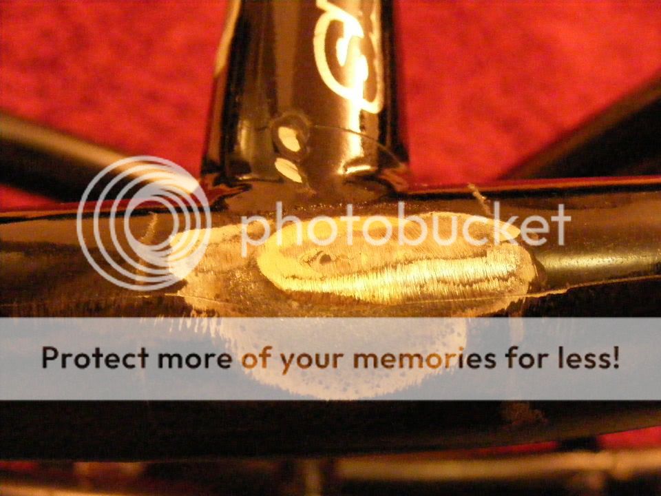

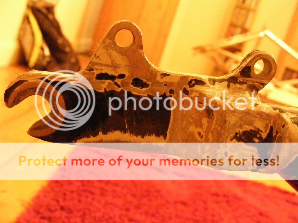

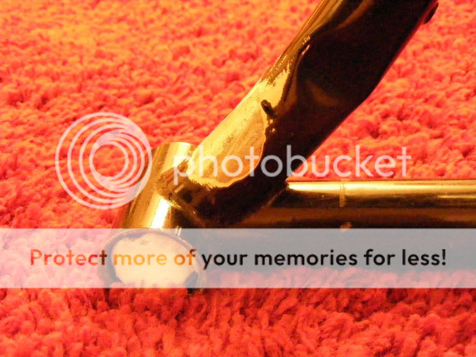

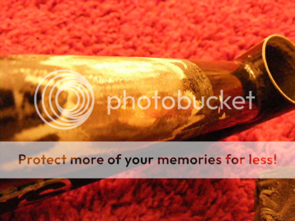

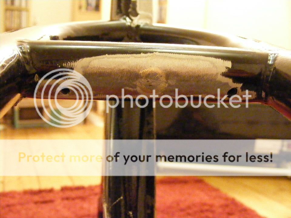

My local welders have been busy of late chopping off the unnecessary parts and doing a bit of rework on the hydraulic hose mounts. I’ve had all trace of the gear cable lugs removed, the e-type front mech boss removed and the middle top tube hose guide moved more centrally. I got the frame back from them today and this afternoon has been an ideal opportunity to dress all the new welds as well as the old ones from it’s last build. I never the chance to dress the welds or tidy it up last time as the deadline of the Peaks caught up with the project. So with a selection of files and the trusty Dremel I got to work.
So, on Tuesday I’ll off to the powder coaters to have the frame done. I’ve asked if it’s possible for 2 colours to be done. They say it’s achievable so all I need to do is make a final decision on the colours. The idea has always been to do the frame in 1991 style, this is still the case, so the centre section will be white and then I’m thinking dark grey for the front and rear ends. The ripped fluorescent sections are being done by hand, copying the style from my cro-mega DX. The decals are being done by Gil, think he’s a very man at the moment though.
I’m also planning on taking a few other parts to the powder coaters. Again I’m not 100% sure of the colours for these parts, we’ll see.
If you're not sure about crank colours, yellow is always a bit of a fave (with me) to compliment black.
Frame's coming along nicely, more little touches making it :cool:
A good quality shot-blaster should be able to remove all traces of frame-saver (if you specify that you want the bare metal taken back to SA 2.5)
