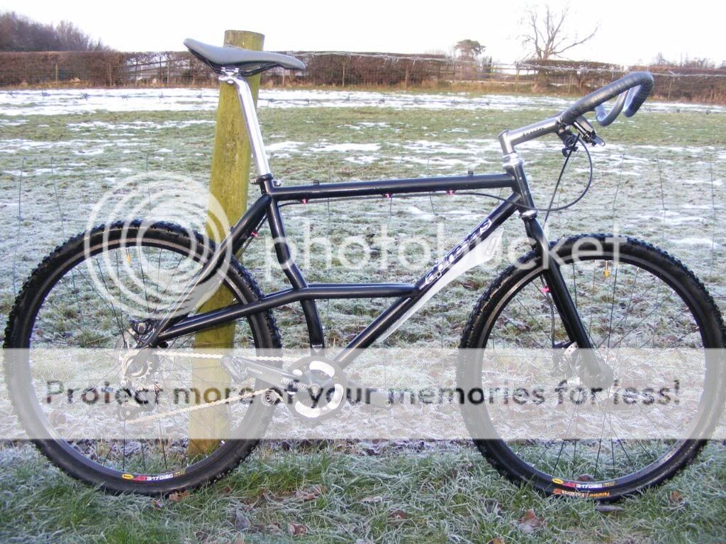

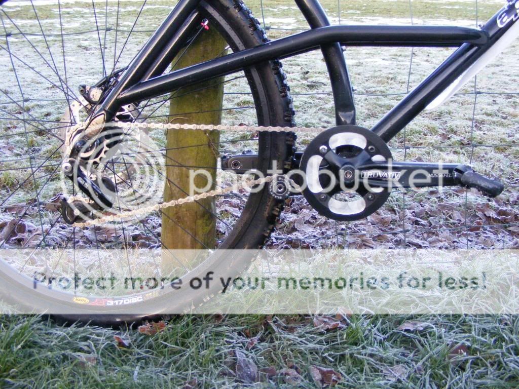

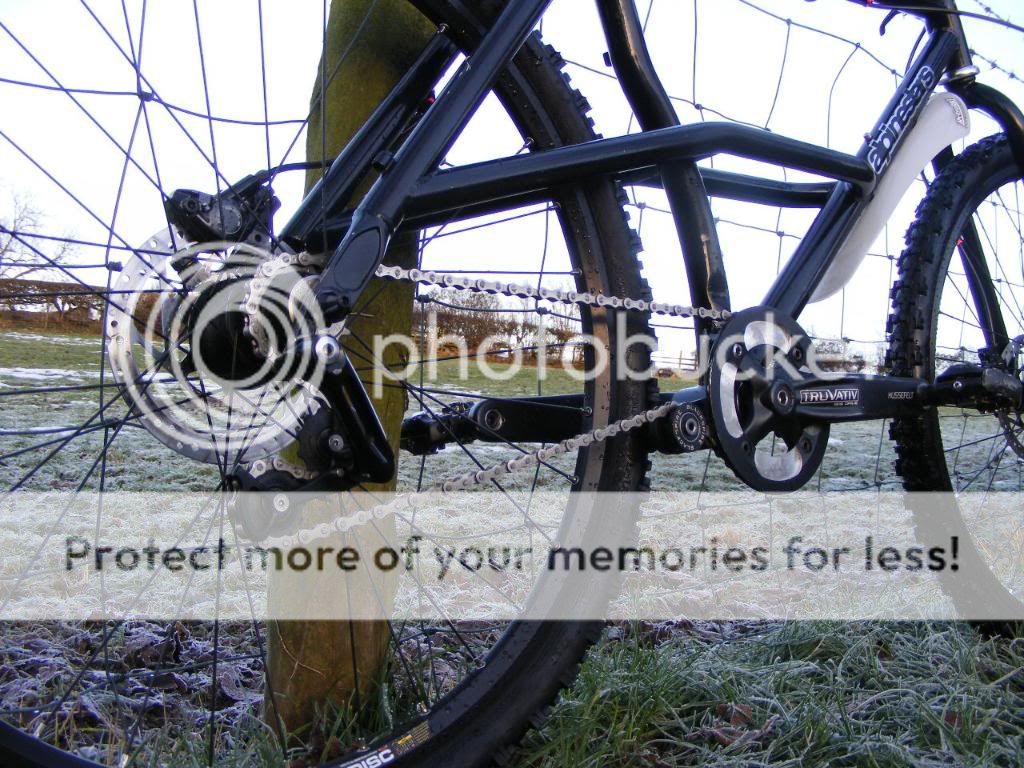

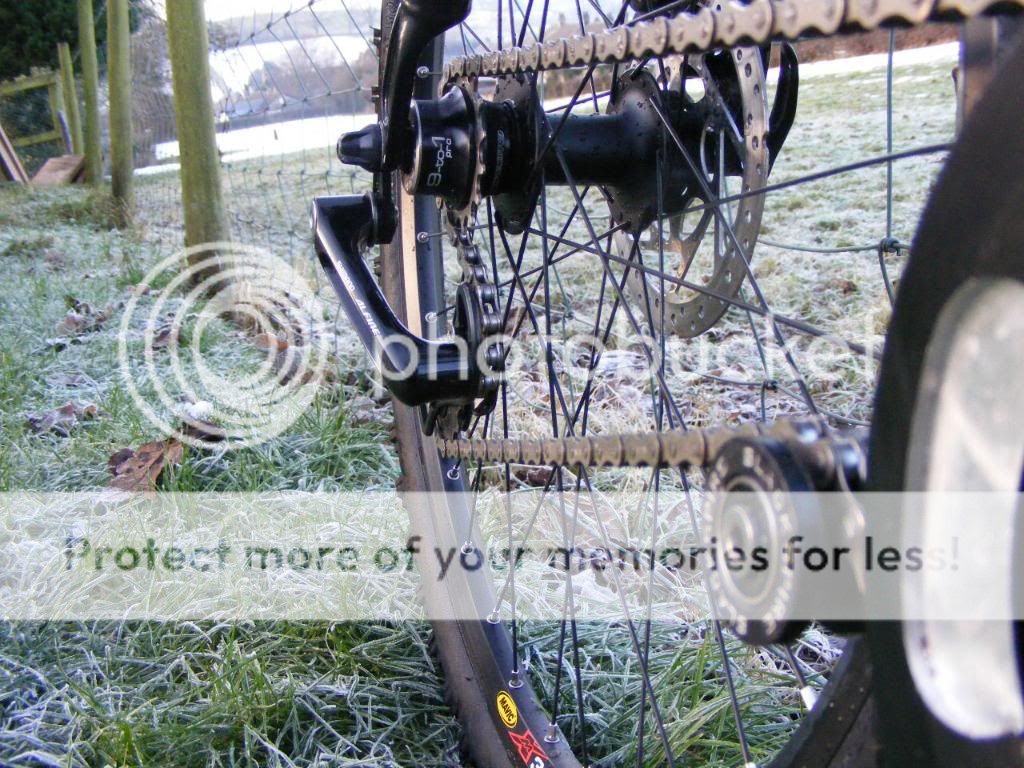

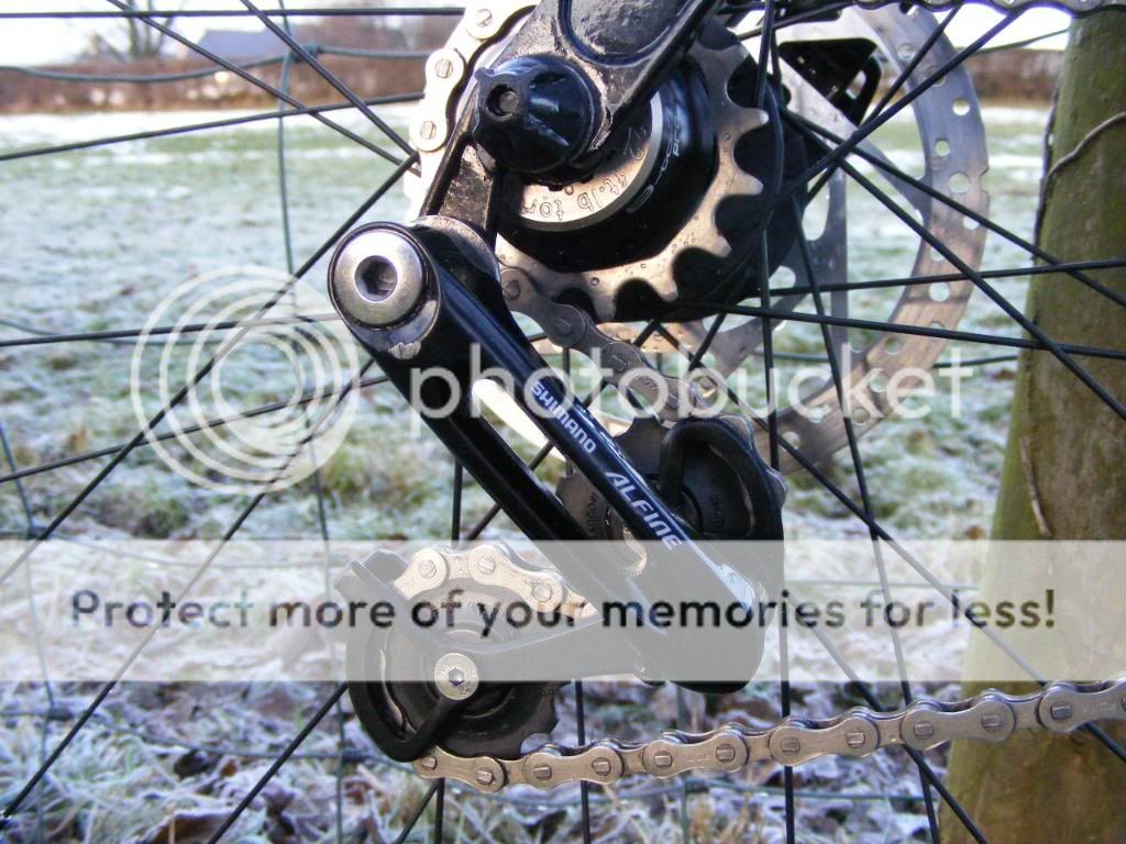

Since the last installment i've fitted a Shimano Alfine rear mech tensioner, which has given the chain all the tension it needs, given me the ability to remove the rear wheel with ease and also given the bike a pretty distinctive look.
Yesterday, the bike got it's first real test in anger at the Retrobike Turkey Twizzler at Cannock and it performed very well indeed. It did have a tendancy for the chain to jump whilst in the worst of the conditions but I discovered that i'd knocked the rear hanger out of line and after a quick straighten it worked fine for the rest of the ride. Think i've got this single speed thing cracked in terms of the bike. The short wheel base of the alpinestars frame means it climbs really well and more importantly they keep traction on the rear end better than any other frame i've ridden, thus i'm massively impressed by this bike.

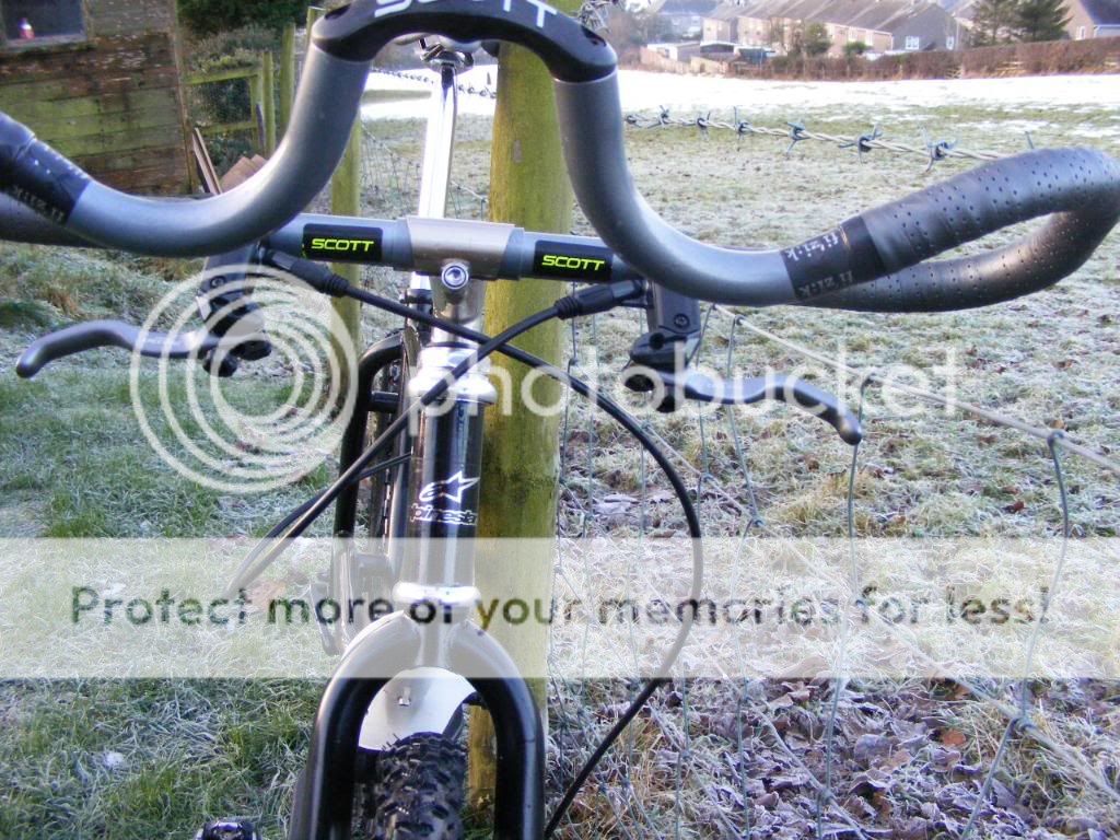

Next step is to strip the bike down and get the Dremel out. All the cable lugs and bosses are to be removed and some general dressing done to weld areas etc. The frame and forks will then be sent off for powder coat, where the grey and white sections will be done. The decals are currently being done by Gil_m and the fluorescent green and pink 'ripped' sections will be hand painted. The components meantime will be hand painted to match the build. The only changes to current spec are possible changes to the chain, saddle, an upgrade to kevlar XC pro's and I might put grips with bar tape on the amazing and much talked about Scott bars.
Very nice indeed, Mark. I'm loving all those 'little' touches to this bike, been thinking about fitting discs to my old AL-Mega project, but can't fully decide?? just how much of a pain-in-the-ass job was it on yours?
Also, one silly question, but what's the point of a rear mech of a fixie?
