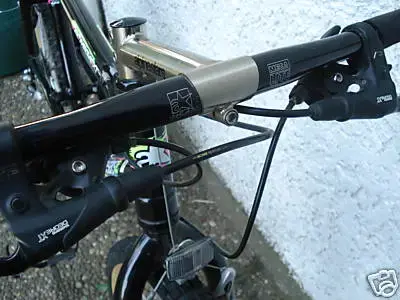

Are the new larger diameter handlebars the same size that Alpinestars used to make?
Not sure on that one but I reckon they might be. The alloy bars/stem you got as standard were certainly oversize and thicker than anything else on the market at that time.
