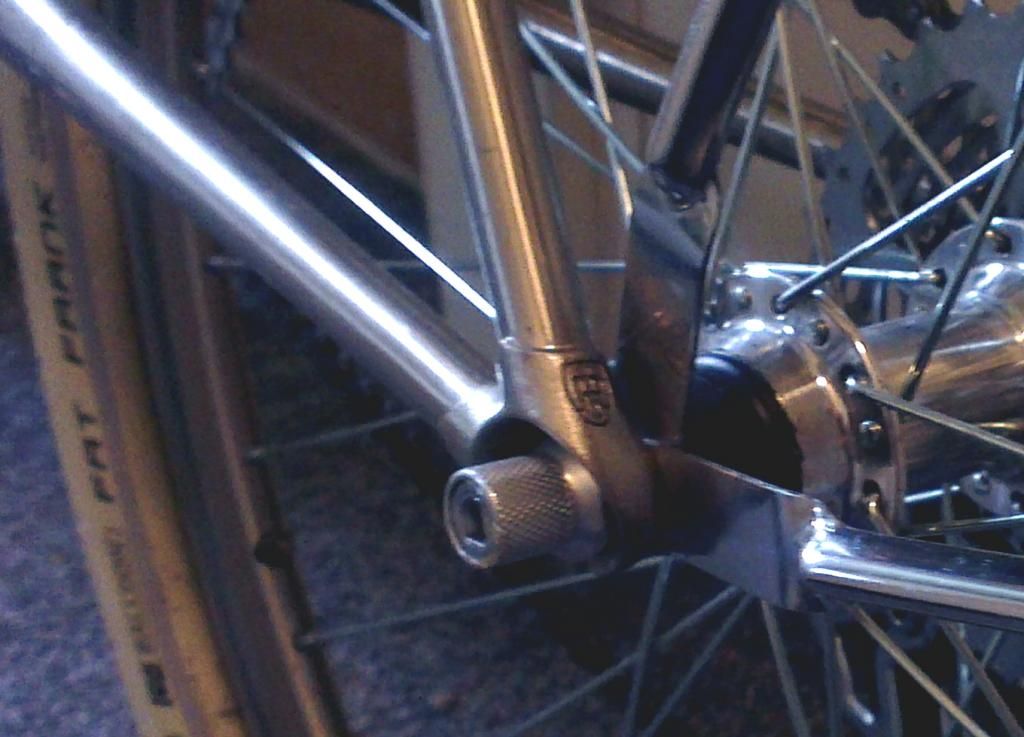

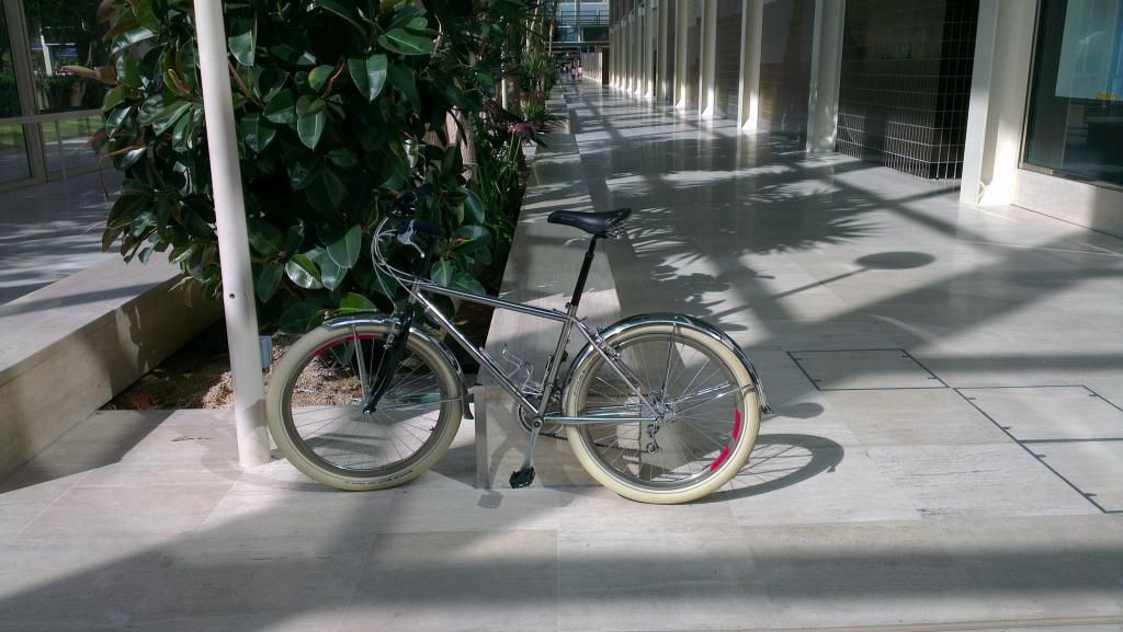

I know this topic is a bit previous and i'm a noob, but please bear with me, as this thread has just told me what my bike is - namely Stewlewis has done, it seems has/had the very same frame..? His photo has expired but he describes it perfectly and i think these pics of my one suggest so..

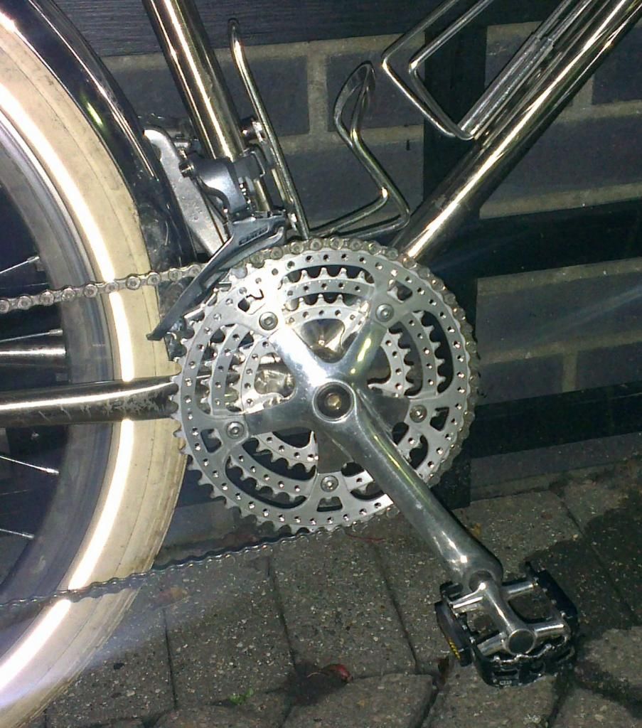

Frame details (twist treatment on downtube only)

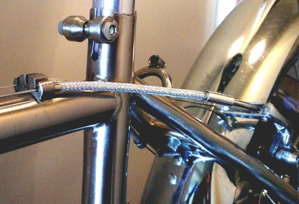

My own brew 30/40/50 drilled rings on Ofmega arms

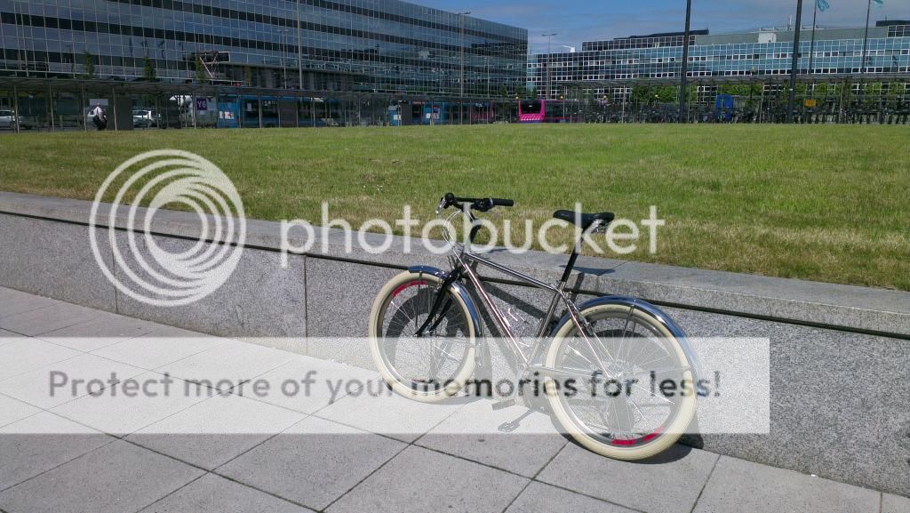

How it looks today

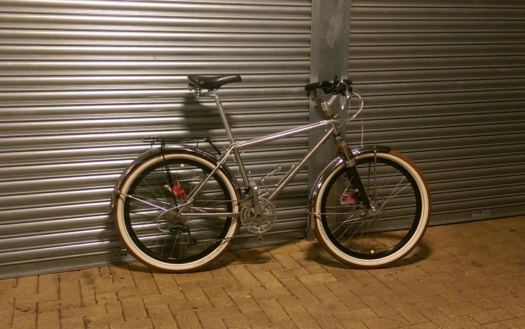

I built this from a bare frame last year, having bought it as a wreck of a roadie build, the only other thing i kept were the Rigida DP22 rims which i've just this week painted gloss black. Spec includes Nexave shifters/levers, Humpert Space Bugle handlebar, Dawes retro seat with custom springs, vintage Suntour XC Pro rear deraileur, the Fat Franks and beach cruiser fenders kinda speak for themselves but i would add that this is a cycleway commuter and grafter that was built to work/play hard on the smooth stuff.
I have a nice Pace Racing carbon kevlar / billet suspension fork for it, the new tyres are the same but with coffee tread and the cream just on the walls, big spun-polished front hub (Shimano M525) to match polished Sturmey Archer 3-speed final drive.. to compliment the HG51 8-speed rear cassette (yes that's 72 gears), floating discs (203/160) and RST calipers.. all to go on in the next week.
The discs aren't very retro, obviously, but as i share with pedestrians (Milton Keynes' Redway system is fantastic!) i need good brakes. Plus the rim brakes stain the cream tyre walls.. But the Pace fork should do it justice, even though it'll hurt drilling the carbon fibre bridge for the fender!
I'll get pics up once it's done, i may have to buy more spokes yet but i'm still aiming for the weekend - And then just to source the correct decals!

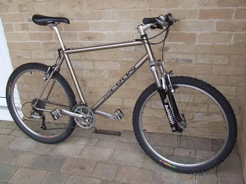

Same fork-type seat stay design and drops as the PW's frame (mine had a brazed-together alloy road fork with room only for 1in thick tyres when i got it so i had to put that cheap lead one on until i found something worthy). I've never seen the Merlin rigid fork, great to have the set, suits it perfectly!

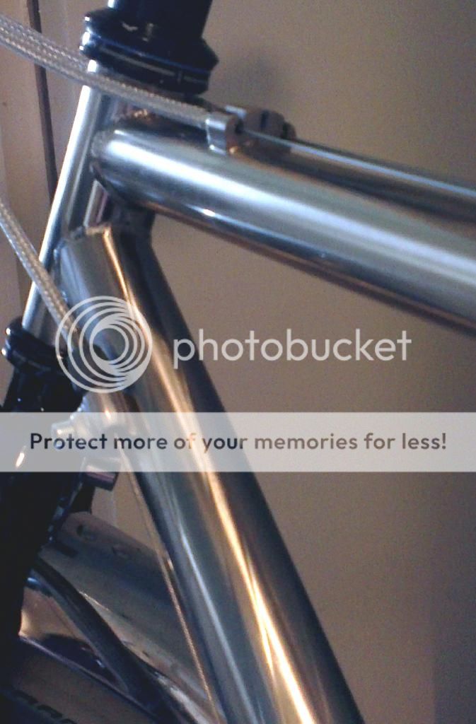

Provision for mudguards/pannier racks there i see too, not so with mine at all. Another headache was the 1in head tube, though i've shimmed the 1-1/8 clamp-type crown for the new bouncy forks.

Forgot about this, i have a 3-speed Elswick Hopper which i love and use most atm (my commuter), the Merlin has a few teething issues but i was out on it today - the RST twin-pot cable calipers stick if used heavily, so i now have some late '00s NOS but generic Deore hydro brakes in the post.
My Nexave levers have the shifters built-in, so i shall have to use the XT shifters i have laying around, these are unfortunately fairly modern 9-speed versions so i'm looking for something a little more fitting.
I've tried to keep it late '90s where i could, the XTR rear derailleur is from around there, the LX front one is black so that too is very previous, both NOS.
The Sturmey Archer CS-RK3 hub is an oddity but well worth having for the cycleway, as it's so much smoother and quicker than even the rear derailleur - the 3-speed unit being ideal for tackling an underpass or such. I use this bike now to pull my kid in her trailer, as well as ride like a fugitive on my own, so the vast gear range is appreciated.
