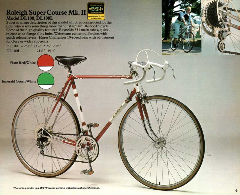

MrW":9ker0gdg said:
It could be a 1972 frame..
I was thinking the same, especially as it looks not unlike a mid-70s Super Course...
Plenty of obvious differences, but very similar paint and decals.
