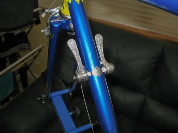

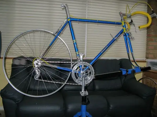

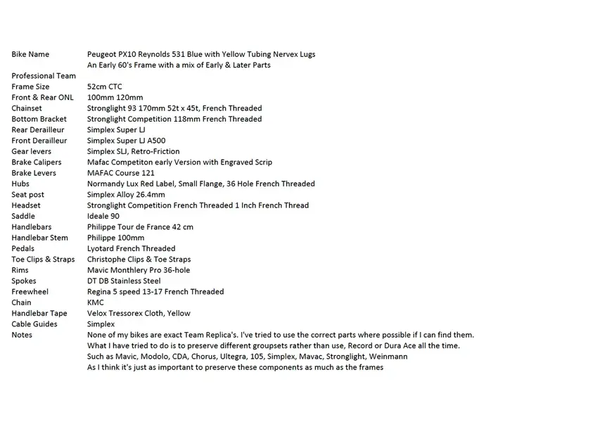

The latest up date on my Blue Peugeot PX10. I'm just waiting for a pair of handlebar plugs to arrive. BUT I've just been let down on an Ideale 90 saddle . So I'm on the look out for the Ideale 90 saddle if anyone has anything?? Sorry about the rubbish Photos I will get around to doing it correctly when I get hold of a back drop.
