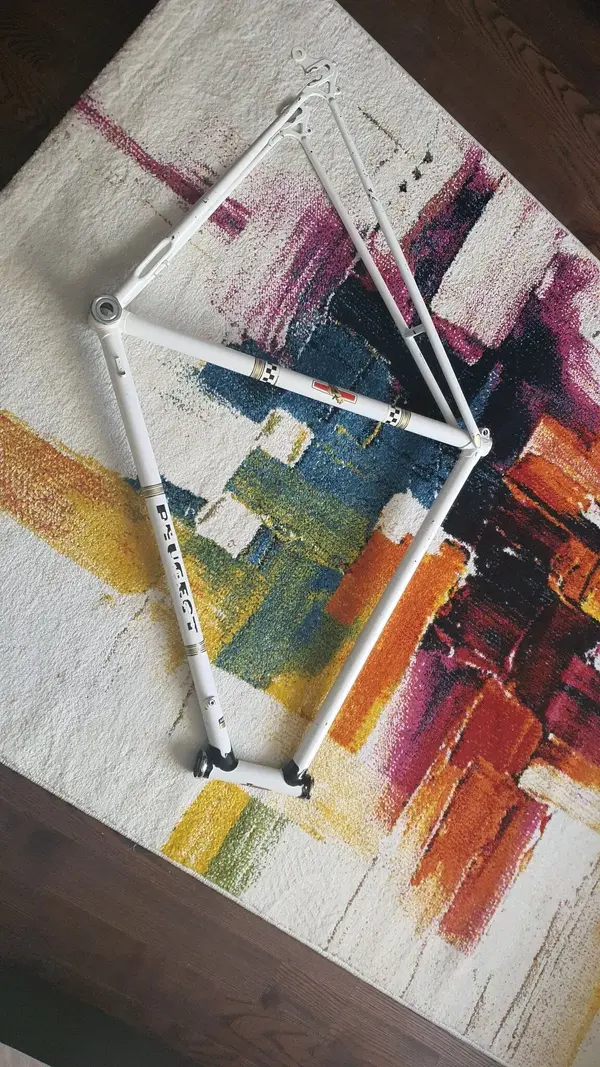

Came back with the answer from BiltHamber : they sugest to try first Korosol and see how it came cause my frame is not rust enough for Deox C bath😅. They didn't say although Deox C is safe for paint or not .

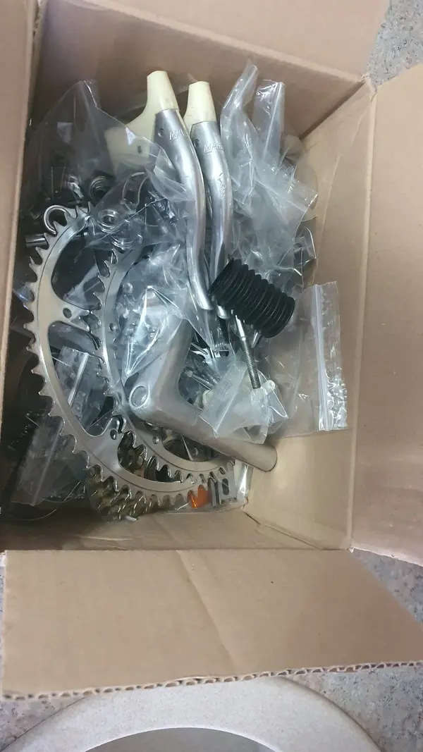

I have finnish to clean all the parts , all packed and wait for Citric Acid bath or Oxalic , then move forward to polish.
All parts here including stern - no handlebar & sadle . Wheels are separated ...., fix bb cup is on the frame , toghether with headset cup. Frame was about 2.8kgs.
As for the frewheel still undecided if worth to invest 60-80 £ in to a vintage better quality one, search for an original equipent ATOM which is about half price or a Suntour, or keep mine and overhaul and run it till die :) . For tubular tyres need to choose between Veloflex , Vittoria Corsa or much expensive Specialized as for shifter and break cables i will go with Jagwire, white housing. Seatpost will try to find original - idk yet which one was mounted , and for saddle will choose a modern Brooks same with handlebar tape.

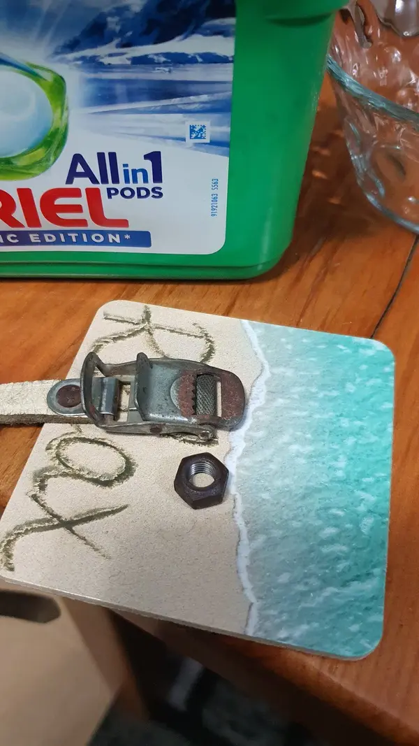

Thank you for your imput @Jonny69 , really appreciate. Most of the rusty bits from chrome parts was gone just by degreasing and cleaning . I have a few more left on the front derraileur and some chrome bolts from Mafac break. I have soak them for abut 12h by now in like 8% citric acid solution.
Rustiest things on my bike was this : - 20221010_211949.jpg
Now more than 90% is gone. I will let them maybe 1-2 h then i will neutralize the acid in a sodium bicarbonate bath and then lightly sprayed with WD40.
For the frame , yes , will try to find a rust converter solution then polish - better to have black spots than rust 🤓 Cheers !
Great work there.
I don't have the answer for your frame yet, but I'm in a similar position too - just need to get light rust off without damaging the paint.
Immerse the frame in a bath of dilute oxalic acid. Sounds horrific, but it does the rust without harming paint, chrome, plating, etc, in the slightest and is very inexpensive. Done 2 frames that way over the years.
Forget your tinfoil, deox, citric acid, voodoo, human sacrifices, flamethrowers and napalm, this outperforms all of them for rust removal and is utterly benign to finishes you dont want damaged.
