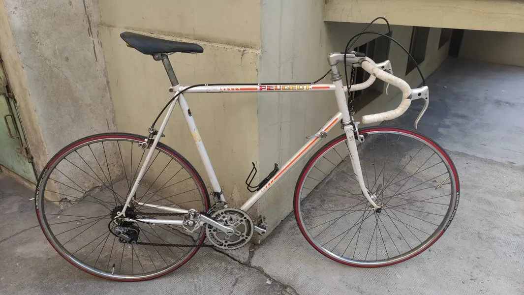

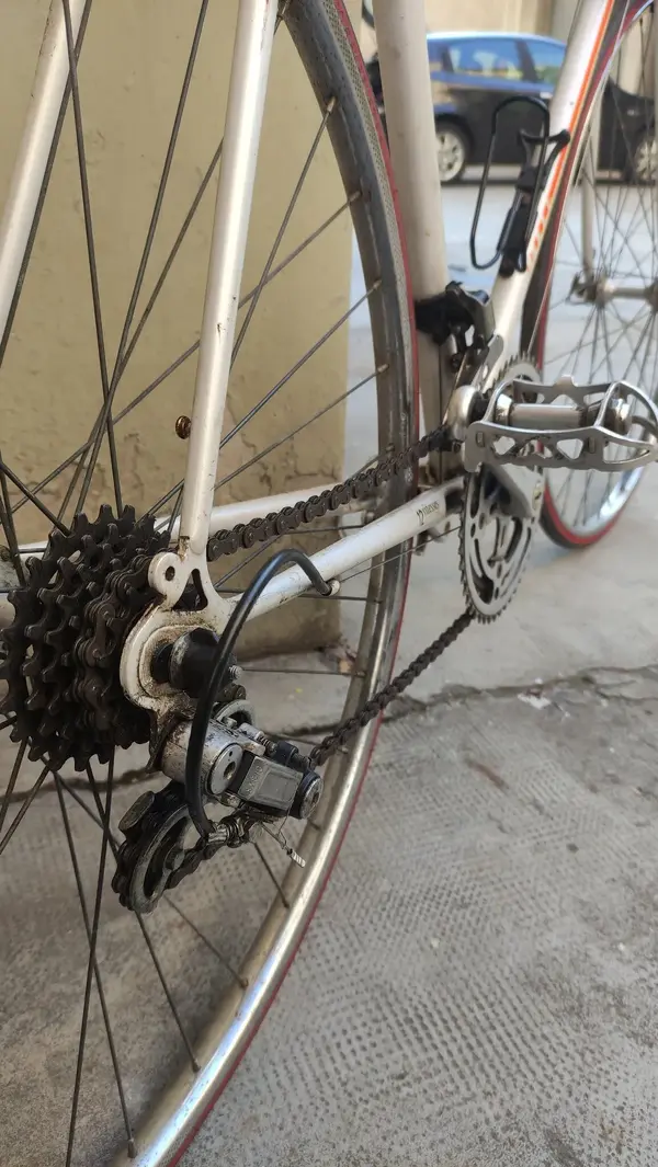

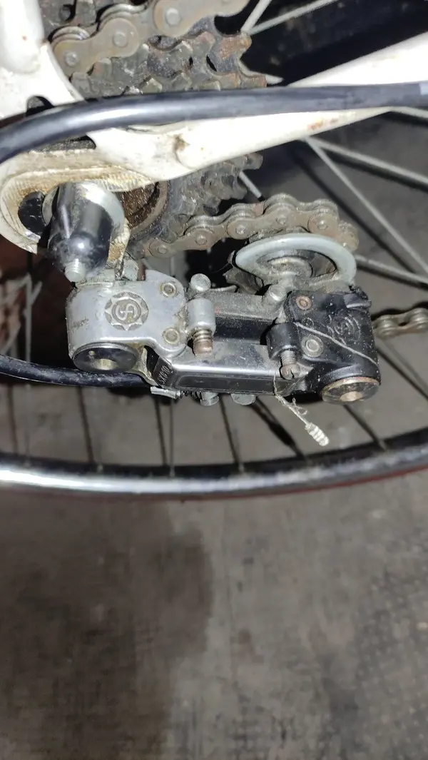

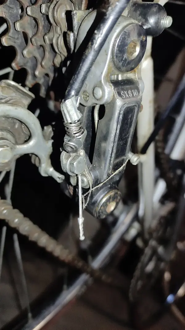

Hello! I got this bicycle today, but rear derailleur is broken. 12 speed. What should be good change for it (simple cheap change or authentic)?
Also what would you value this bicycle? I don't know if this Shimano computer works or not

Quite common for the Delrin mechs to break. Lots of period ones Huret, Simplex, Shimano on ebay that would suit, not expensive either. It's not a high end Peugeot but will ride just fine. Clean it, repack the bearings, cables, pads, tape and maybe tyres. Spend as little as possible as the value is not high.

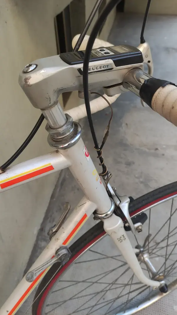

What do you think about computer? I will try it later, hope it works. But it seems pretty rare and expensive SHIMANO CELC SH-CE10 bike computer stem - it goes with specific fork with a hole for cables.
