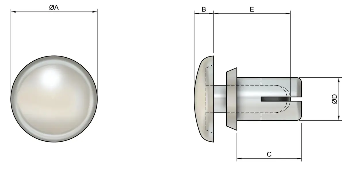

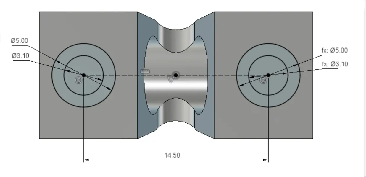

BUT...I've been working on my own model of the Pace guides over the last few weeks for a client who is restoring two RC100s :cool:
I have some real, but damaged, ones from the frames to work from for the form and dimensions.
Mine are designed them to work with separate dome-headed push rivets, rather than the built-in one time pin system that Pace used, so should be more easily removable/replaceable.
Currently being printed (LSPc resin), in grey, and should be with me in a few weeks.

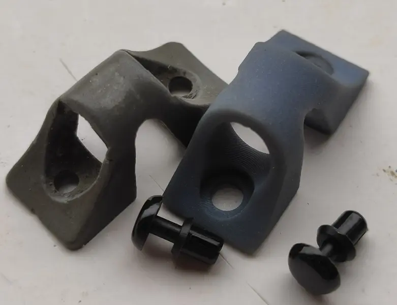

Yes, sorry, I forgot to post an announcement here:confused:
Here's one with a tired and weathered original. The repros aren't as blue as looks on the pic.
Plenty still left. :)
£4 each + £3 UK postage...so £15 posted for a full set of 3.
