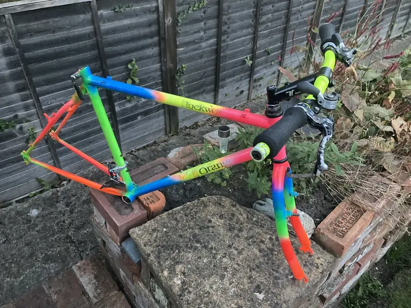

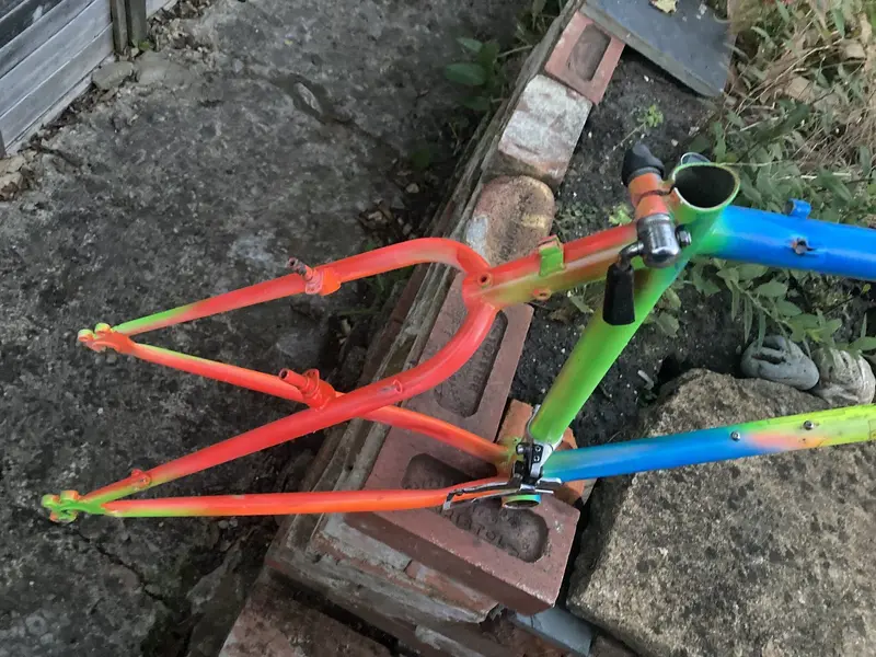

So I bought Spankyb's uniquely painted old clockwork frame and fork recently.

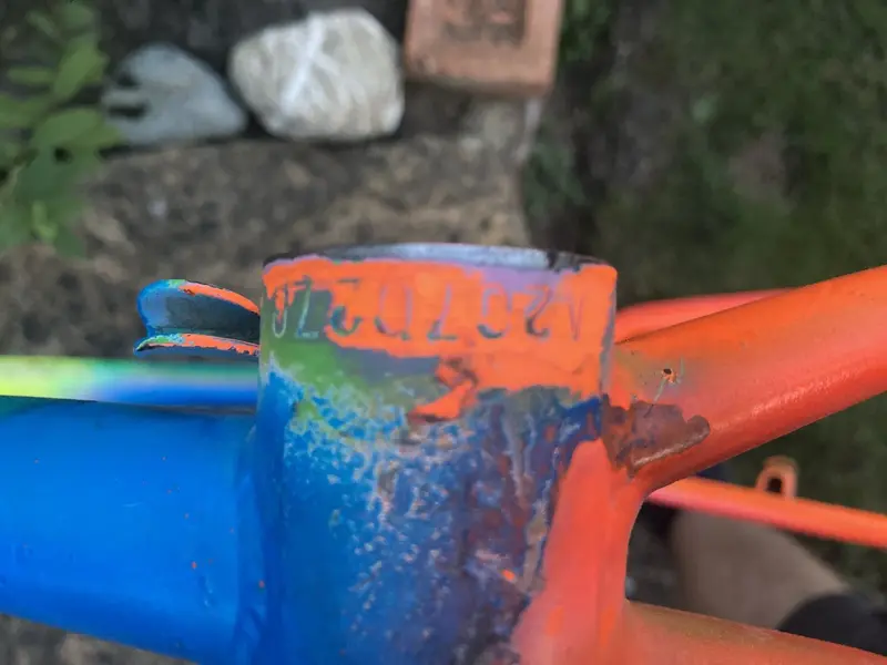

By frame number can anyone confirm year, and tubeset for decals ? I read it A20702Z0..?

If youve ever successfully painted one, leads on a suitable orange? I settled on a vw orange but test spraying on some plastic tubing has me doubting this...

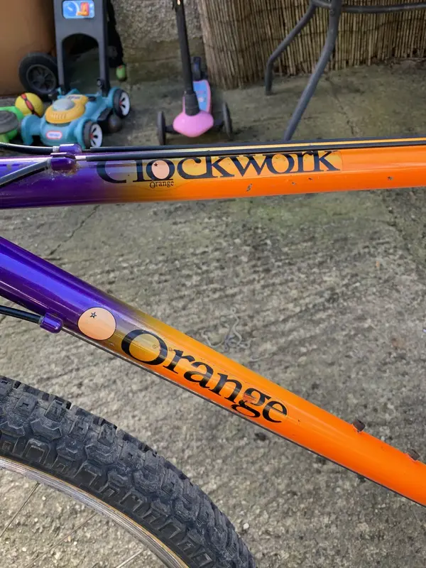

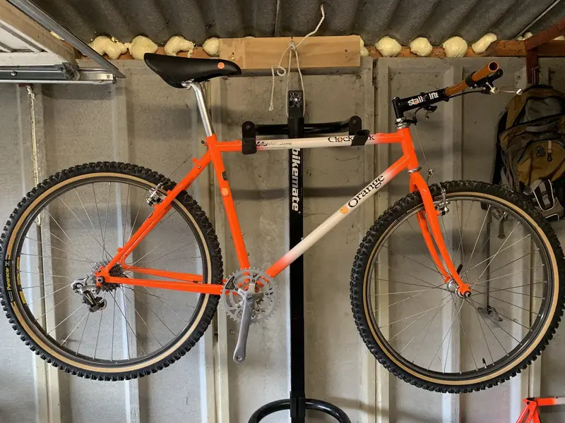

Yep, 26.8mm seat post on these, it'll be a July 1992 frame made with Tange Infinity tubes. The orange changed over the years, ranging from neon to carrot. Decals should be as they are in the picture, here's mine. Let me know if you want some specific pictures.

No worries Ben. The white should have a pearl type finish btw.

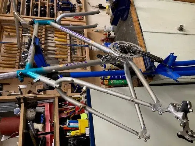

The silver/teal colour was the era that took over from my ones above and was offered for a few year around 93/4 (late 92 as well from memory?) and crossed over to the early C16's and switch from Tange tubes to Orange branded ones.

Yeah, basically orange/white, purple/orange, silver grey and black were the 1992 model year colours, silver/teal, orange/white and black the 1993 colours (with the block type decals) but there was always some overlapping.
Check out the cable routing as in 93 it changed to all three cables routed along the top tube, unlike your 92 above. The switch to Orange branded tubes seemed to coincide with the move to P7 and C16 although they did at least one batch of Clockwork's, probably in late 93 before the C16 took over for the 94 model year. Confusingly there are a few C16's in teal/silver!😂
Three on the top and these colours so '93.. good to know. It had varnish spilt all over the bb area and the forks, and the chainset..
Most of the chainset polished off after i stripped the bulk of the varnish with 2k thinners, the frame not so lukcy.. the teal appears ot be enamel sprayed over what looks like powdercoat, certainly the silver is tough the oversprayed teal is not. So for the foreseeable ive repsrayed with a similar silver the bb shell area and the forks.. its looks ok got me stopped a few times in Cornwall, they seem to love older bikes down there.. and the rest is too nice to be faffing with repaint. Unlike the rat project... that is in need of restorative justice in my opinion!
