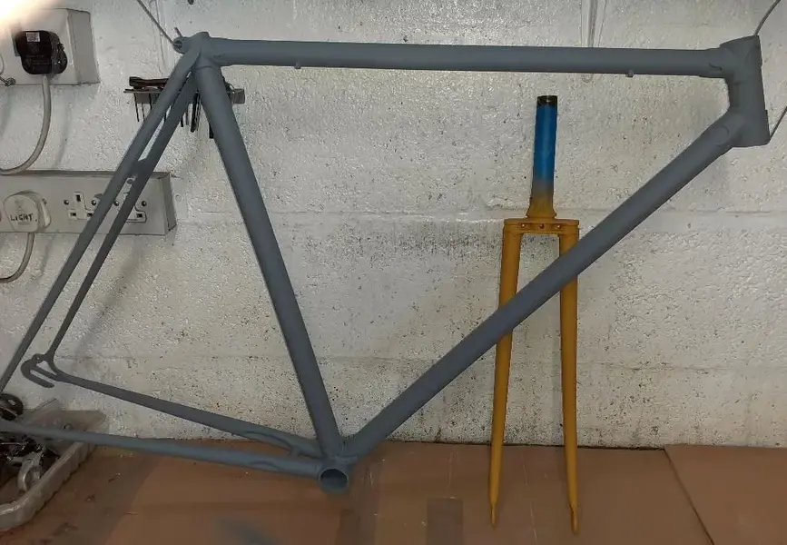

Hi, since I've committed myself to making a bike out of this frame I may as well start right at the beginning.

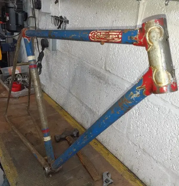

This frameset came to me in a clearance joblot a few months ago, didn't know what it was but I liked the lugs/ the size (21.5") and the cast crown forks, so a couple of weeks ago I set about it.

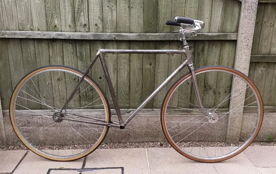

The forks were bent and so was the rear triangle, but with a bit of brute force and trial and error it straightened out OK so I stripped off the paint and dropped some wheels in - as already shown in the Vintage French.............. thread.
lugs2.jpg At this point I started to research what it was - and the only similar lugs/fork combo was on this Oscar Egg, so that sounds good to me - I like unusual bikes!
20160624_090403_1800x1012.jpg 20160624_090353_1800x1012.jpg Having a garage full of bits means it's going to be a sympathetic rebuild using mainly what I've already got but keeping the vintage look.
The frame is now in etch primer and the fork is in filler primer.
I think this is the "easy" bit but deciding on a colour will be hard and finding a 25mm French headset top race won't be easy although I have yet to sort through the box of headset parts that came in the same joblot - so if I'm lucky the original might be in there.
More to follow soon.

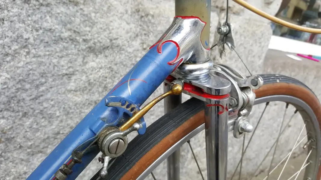

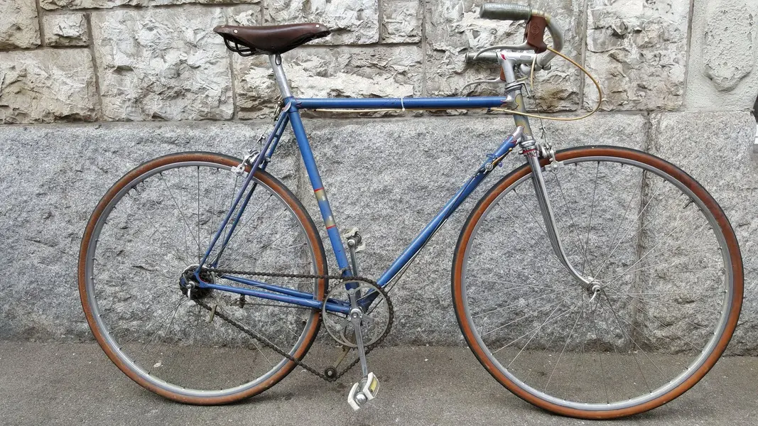

In my quest to identify the frame I trawled the internet for similar lugs, the only similar ones are Oscar Egg - but the only ones that are exactly the same are on the bike in the photos 4 & 5 above and the forks are exactly the same too. So, if that's an original Oscar Egg then mine is too.
In other pictures of the bike at tps://velo67.ch/products/oscar-egg-gentleman the method of flattening the chain stay at the rear drop out joint and similar on the front drop outs is exactly the same as mine.
Googling Oscar Egg lugs predominately brings up the Super Champion design as used by several British builders, but searching Oscar Egg bicycles shows bikes with quite a few different lug shapes - it appears that those on my frame are not common at all.

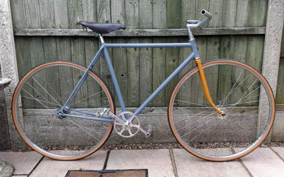

Anyway, I found a couple of top races and nuts today so I've made a little progress and got a working headset.
Wow, some good reading there - I'll have a scan through and translate the interesting looking bits - thanks!

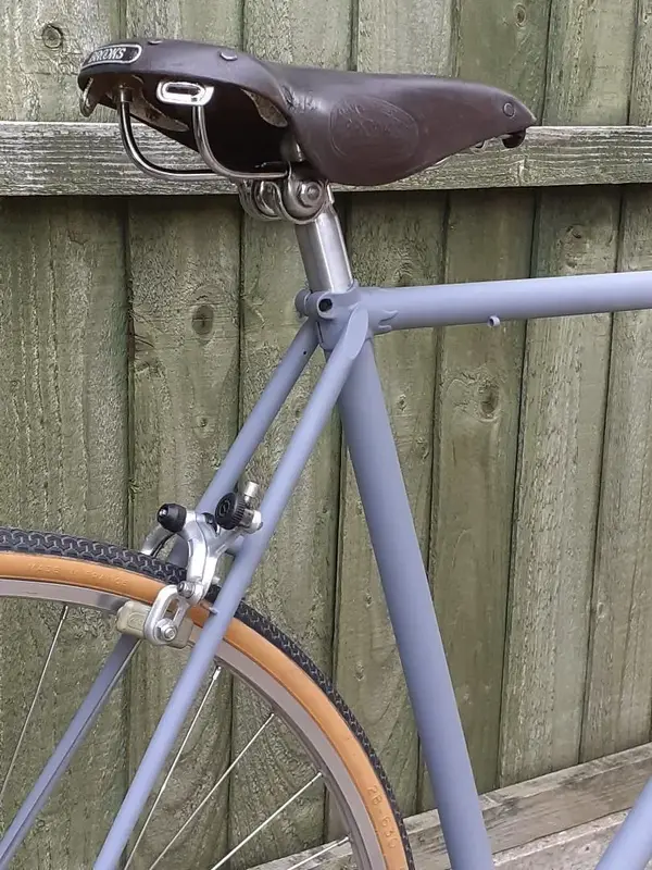

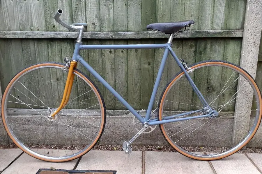

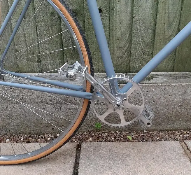

Meanwhile, tried out a few bits today, another pair of 27" wheels with 5 speed SA hub on Weinmann rim rear and Normandy QR hub on Weinmann rim front - Weinmann 500 brakes will fit and might get away with a 730 on the back, Stronglight 49D with 44t TA ring, Brooks early B15 on Reynolds Hidi domed seat pin. AVA stem and GB bars.
Fitted the headset but put an extra lock nut in as I don't want to trim down the steerer tube yet because a nicer headset might come my way and I might need the extra length, works fine though but had to use crowded balls as I dont have any caged sets that will fit the races.
I should get it rideable next week and try the 5 speed SA (I know vcballbat will approve!).
Nothing's set in stone yet and it's all got to come to bits again for paint and decals and if I like the hub gears I'll more than likely swap the rims for Weinmann 700s. e14.jpg

Forgot to add, as it stands in the pictures it weighs in at 21½ lbs, so with a chain, cables, levers and grips fitted it should come in at about 23 lbs - so it's no clunker (but not really a lightweight)!
Mind you it's got to have another 3 coats of paint as well.
Ooo - and the SA 5 speed shifters - they weigh about ½ lb on their own! Make that 24 lbs.

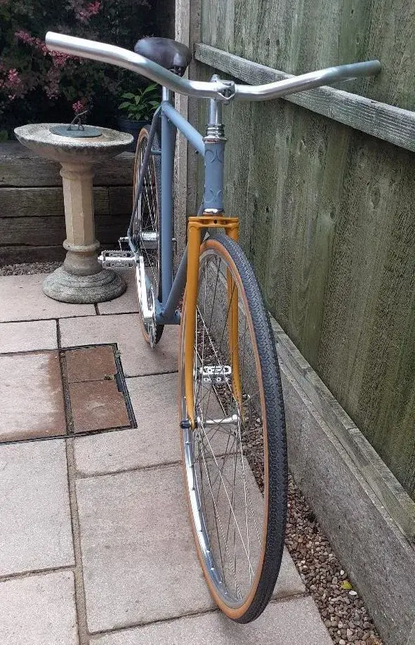

Mine was a frame and forks only but I took a liking to it and wanted to save it.
It'll not be an authentic looking restoration but I intend to make a rideable bike out of it using old parts - French where possible. Components will be swapped and changed as I come across them.
