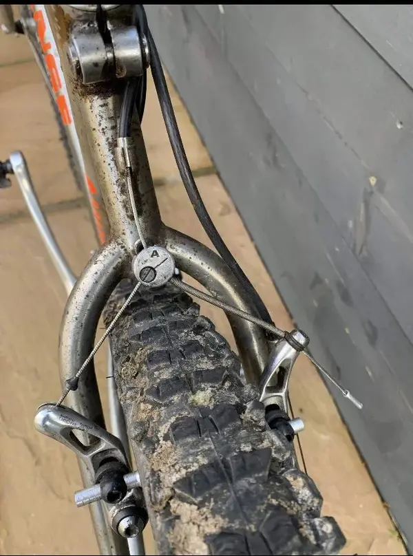

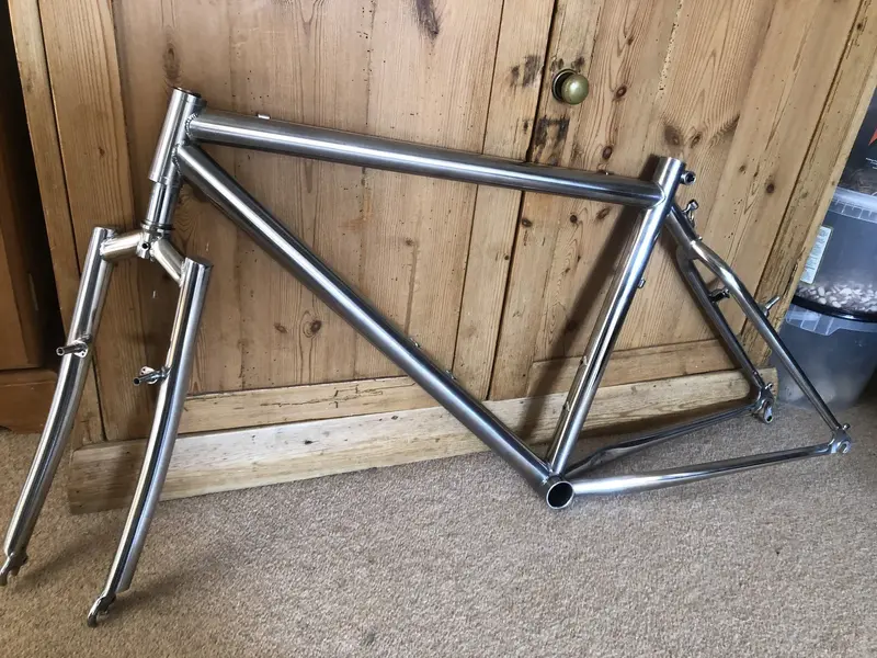

After some advice if possible please.... ok I’m pretty surprised that I’ve been able to pull back the finish on my P7 as well as it has turned out despite thinking the frame was beyond doing due to heavy amounts of rust and corrosion especially around some of the welds and bottom bracket areas in particular....
My quandary is now is what to do about protecting the finish as I don’t want it rusting again as I’ll be using the bike as much as I can hopefully 👍
I was initially going to have it powder coated and still thinking about doing this but in a chrome like finish as this is potentially lined up with a specialist powder coating firm to do but I know it won’t look as good compared to the ‘naked’ finish....
The other option is to just clear coat it or can I not worry about future corrosion issues and rust by simply using waxes to protect the metal surfaces....
So my question really is what have other P7 owners done and their reasons for or not for doing what they have.....?👍🍊🍊

Thanks guys, to be honest it was in a bit of a state and pretty unloved when I received it and was simply going to just send it away for powder coating ....
The process was slow but has worked very well in the end....
I’m use to dealing and polishing aluminium so it’s been a learning curve. Paint stripper ( the cheap stuff from screw fix works really well) is great for taking off any lacquer. Once any old decals are removed GT85 and the fine stainless steel scourers you can buy for kitchen cleaning etc are the ticket 👍 apply plenty of GT85 and use the scourer to remove the surface rust etc. Don’t need to scrub hard or you risk removing the nickle finish but you’ll be surprised how effective this method is. I also used a dremel for awkward areas again using GT85 and a fine wire wheel👍 I find Autosol is a good polish as it’s a more ‘gritty’ paste and more abrasive I find for polishing up on still/chromoly etc and works well for me compared to other polishes I use normally for aluminium. You will still have little areas of pitting etc that you’ll not get rid of but the over all finish is a huge improvement. I may still get mine powder coated but have not decided yet👍🍊

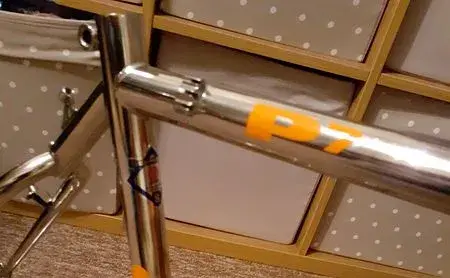

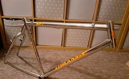

I done this one a couple of months ago

My nickle P7 has never been ridden in the wet, always been kept in the dry, appears to have a thin clear coat of something on it by previous owner, YET STILL it has started to have spots of corrosion around areas where the clear coat has flaked off a little.
The issue then is how do you tidy up just those bits rather than have to strip and redo the whole frame every couple of years ?
The clearcoat is standard.
A little spot cleaning to remove the corrosion, then WD40 or a silicone spray to repel water.
