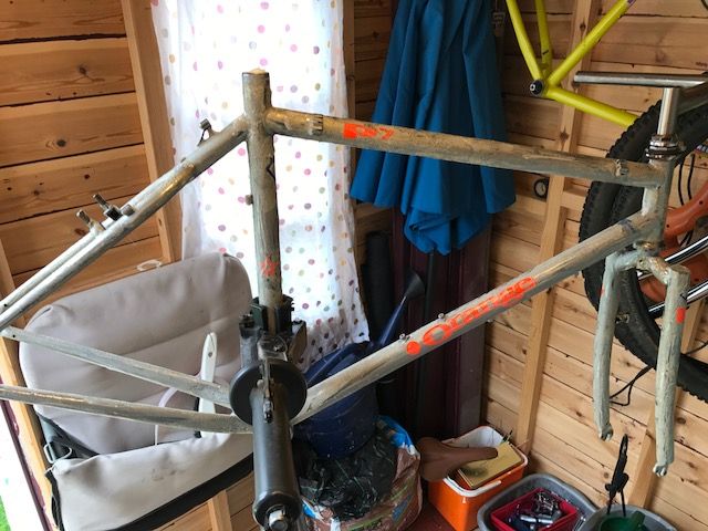

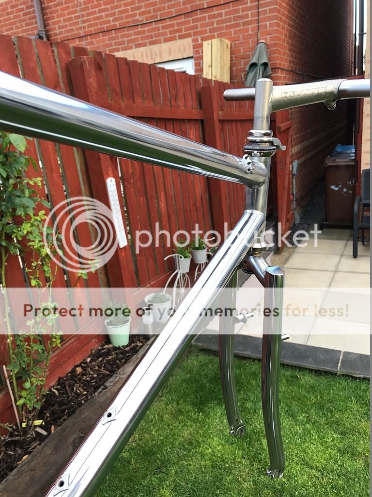

now completely stripped and gave it a quick clean tonight.
guna try the coke an dtin foil this week as some small spots of service rust. then fit the full XT

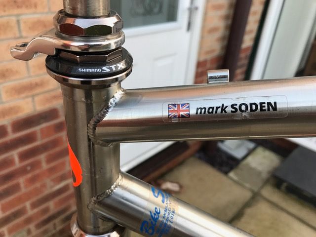

on a side note does anyone know what the mark soden sticker is?
That looks like one of those ones you get advertised on Facebook all the time.
Just a previous owner's name I'm guessing.

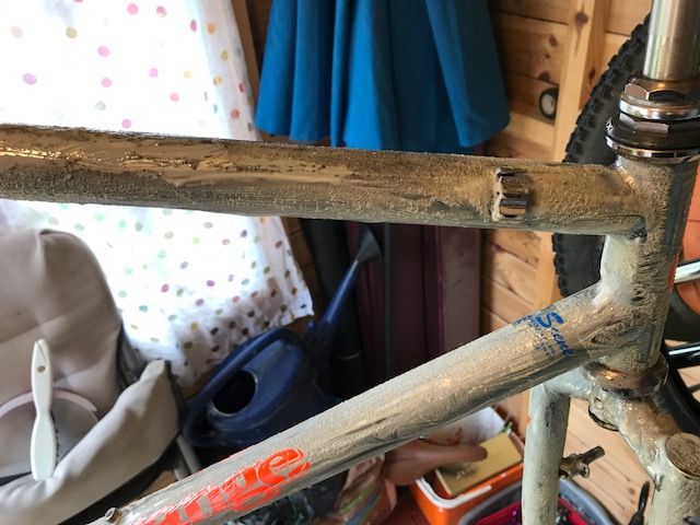

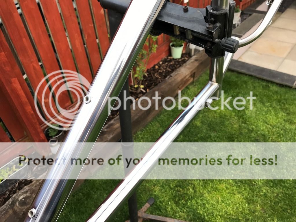

needed to strip the lacquer and after trying the tin foil method - way to much like hard work - i went and bought some £3 paint stripper form wilkos.
its like a glue and just painted on
left for about an hour
went like snake skin. filled a bucket with some soapy water and a green scourer and it come off so easy!n gave it a good rinse and a thorougher dry

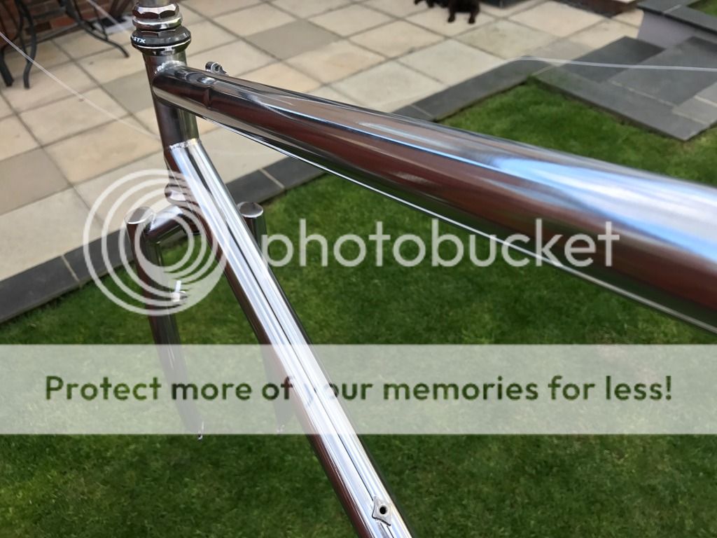

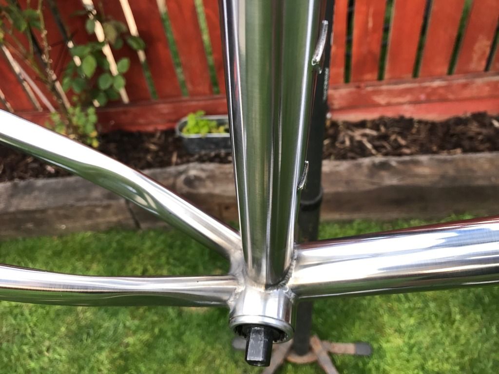

real happy, not time for some autosol and fine wool :)
now all polished :)
think its come up really well. used the paint stripper and then autosol and fine wool. took a few hours.

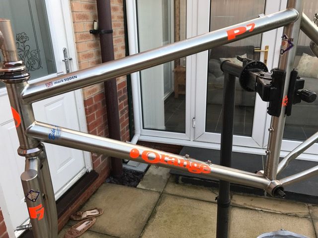

need some decals for her now and have emailed the chap off here but no luck :-/
are these off ebay any good?
http://www.ebay.co.uk/itm/Orange-P7-mou ... SwONBZCG4l
Wow! That's well shiny now – really nice work there – are you leaving it just polished and without fresh lacquer?
With the decals – there's something not quite right about them. Series 8 stickers should have a purple border on silver foil; the F7s don't have a kink in the main body of the 'F' element; and the large main Orange font decals are not drawn correctly. Check out this P7:
http://www.retrobike.co.uk/forum/viewto ... p;start=20
