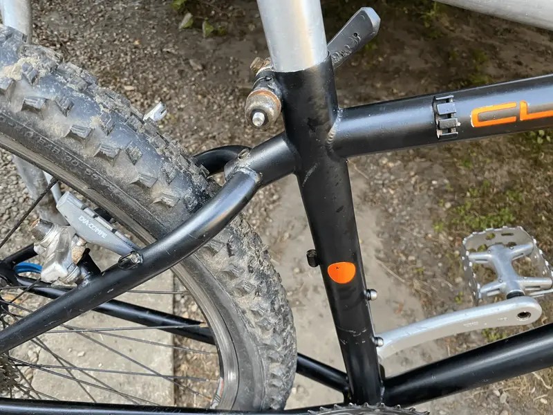

Hi all, I've got this 14" Clockwork frame and I've started building it up with spare bits, but it seems I'm missing something in order to fit the rear cantis?
I think there should be a raised rear cable guide, or maybe it's meant to have v brakes?
Does anyone know what I should do here?
pls ignore the rusty bits, they won't be staying!
Thanks!

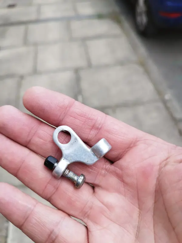

I had a very small clockwork that I built for my wife. It had a mount that sat between the slot in the seat tube and the seat post binder bolt that the cable routed through for canti brakes..
Like this:
