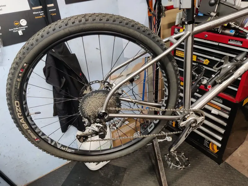

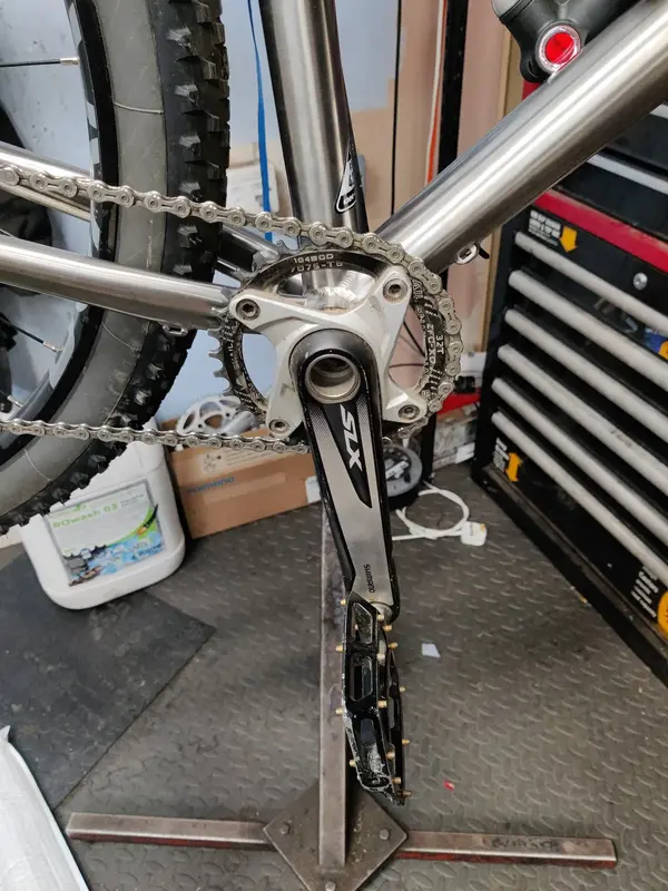

I was forced to wait on a headset arriving from Chain Reaction (Hermes rebranding as Evri has had no effect on their appalling service, but that's a long story in its own right) so I put the back end together pending the arrival.

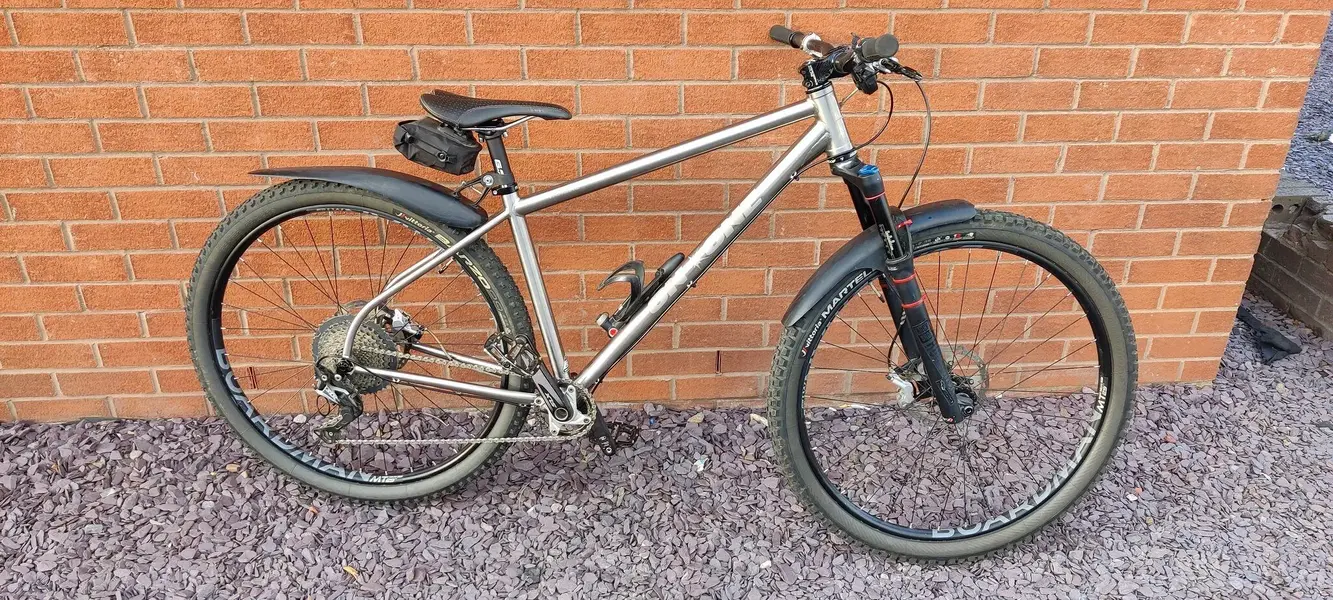

Received the headset, and have thrown everything together.
I'll get a dropper post on as soon as I sell my 31.6mm one, I'm being strict with myself regarding funds in and out.
The steerer is a bit short from the donor bike, leaving me no room for spacers and the brake levers hit the frame when I turn the bars to the extreme, so I'll need to fit a higher rise bar, or swap the fork, which would benefit from being a 130mm travel, beefier stanchion type now that I see the Rebas fitted to the new frame.
I'm also going to fit a shorter stem, as this frame is much longer and slacker than my last, and it doesn't feel right with the 50mm Race Face stem.
Turns out I had a 35mm stem on another bike, so I tried that on the Vandal, and it has sorted out the handling, it feels much better.
