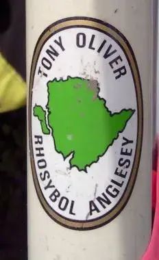

I need a bit o& help if possible. This Tony Oliver Bike came into the recycling workshop and we’ve little to no idea of its value. It’s Reynolds 531. its been “upgraded” by its previous owner but we’ve removed most of that and fitted new chain, cleaned up,hub, changed (and recreated cables) for the 5 speed (yes 5) sturmey archer hub. Any guidance appreciated
Is this the really light ATB built in Wales in 1986 ??

Yep, I,actually touched that very bike this afternoon... didn't say I rode it though, did I.
