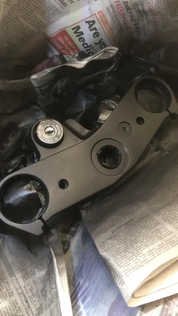

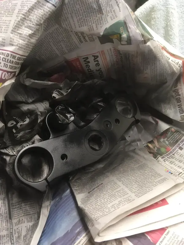

Using standard car satin black paint, first stand the tin in a little boiling water in a bowl to warm the paint in the can. Then shake for a couple minutes and apply in very light dusty coats for first 2 x coats waiting 15 mins between coats. Final coat can be slightly thicker but keeping it light will mean that the serial numbers will not become ugly and unrecognisable with paint. Prep and patience is key.
Top tip… before each coat blast the first squirt of paint on some newspaper as the first blast always risks a couple of uneven blobs coming out from the aerosol and keep those coats light and even spraying horizontally then laterally …

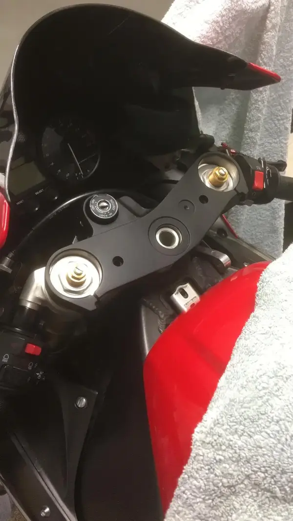

Here’s an example of the results I’ve had on the top yoke of my R1 motorbike using this method. I’ve done some of my pals too as they often get scratched from owners leaving keyrings attached to the key that whip about at speed and scratch the Uber thin factory satin black paint. Unrecognisable repair if done patiently.

Never understood sportsbike owners (in particular) having a bunch of keys swinging across the top yoke. Even seen it on track days!
Nice job
