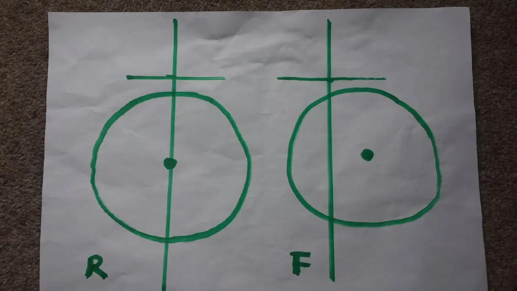

Well... I might be wrong about this, but as far as I can see, there is nothing about building to a specific top tube length, or to a specific fork rake, or both at once, that prevents you from choosing a specific brake drop, and getting the brake drops equal. I mean, they are never perfectly equal, but sufficiently equal that one pair of shoes is not noticeably in a different part of the slots than the other pair? If both pairs are near the bottom of the slots, ok. If both pairs are near the top of the slots, ok. If both pairs are near the middle of the slots, ok. Anything else looks like a lack of attention to detail to me, but like I say, I am open to having the rationale explained to me, if there is one?
A simple drawing of four lines and two circles might help. ;)
That's not an accurate representation. Seat stays are not vertical in elevation, and along with 40 odd mm of fork bend, there is about 25mm of forward/backward axle positioning potential in the rear dropouts, as you know..

Woz the first sentence in my post was directed at the last sentence in yours. My apology was directed at anyone who derives no entertainment from my obsessing over brake drop anomalies. It seems that every time I ask for a rationale, I get a diagram that suggests some sort of fork rake-related inevitability to the bigger front brake drop. I know this to be untrue, and as you say, it is a no-brainer to put the rear brake bridge in a position that matches the front. The question is: Why wouldn't you?
I've been through Bagpuss's link without finding an answer. I doubt I'd find an answer in Paterek either.
