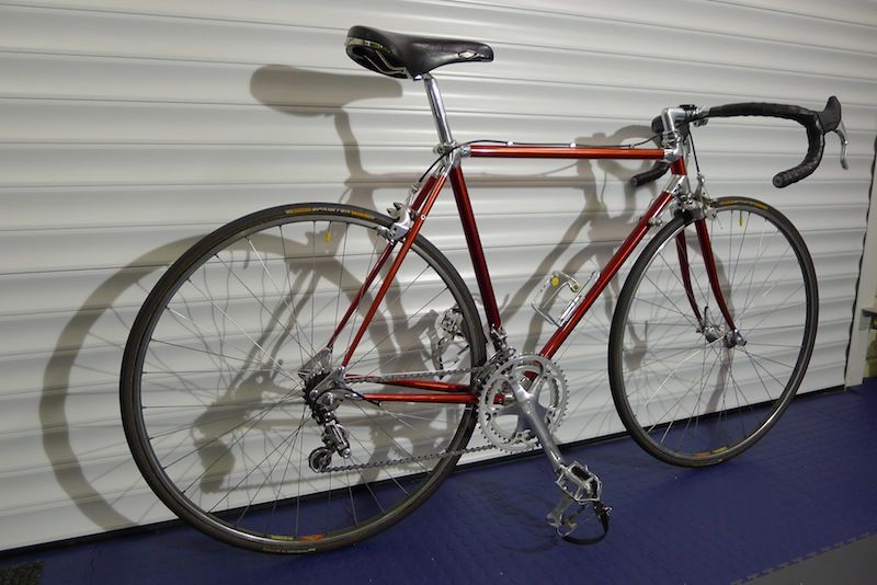

Purchased this Bike from Italy last week and it arrived last night. Looking at the frame; it is in very good shape with very little use.

From close examination; the head tube badge, top of the fork decals and the bottom of the down tube decals seems to be the only original markings. I'm guessing the yellow lettering is fake and put on there for cosmatic reasons for eBay.
I searched various forums but couldn't put an year to the frame. I'm thinking late 90s from various sizes and cable routing.
Would appreciate if someone can shed some light into when this frame was built.
As for the components, I'm yet to identify the following:
The seller told me the hubs were Campagnolo Records (9 speed). However, there are no markings on any of the hubs apart from the front dust caps and the Skewers having the words Campagnolo stamped on them but no wording to say "Record". They do have the lube holes in the middle.
Not sure about the Crank other than they have Miche rings.
Stem possibly Deda ???
The bike is missing Brake/Shift leavers, Rear cassette, Pedals and the rear Derailleur.

A nice package, the frame itself is early Alan from the 80's and they were very ahead of their time which may explain the previous owner's desire to put 90's parts on it. Your parts appear to be a Chorus/Record (9sp period) mix from the late 90's. The hubs are Chorus or Record but check the brochure section of this site for an accurate ID. Chorus and Record are Campagnolo's top end groups, can I suggest that you'll be doing them a dis-service by now pairing them up with lowly Veloce and Xenon. Chorus rear mechs can be got for around £40 on eBay.
It's much newer than the early 80s, early frames never had internal cables
ALAN used to date stamp the seat tube up near the top, check there and see if there is any numbers
This is a 1980 ALAN Super Record
Thank you both for the replies. Why I think it is a mid to late 90s is that apart from the internal cable guides, it has shift adjusters for the cables where old shifters would have been. Hence, the frame was designed for handlebar shifters.
I traced the hubs to be "Campagnolo Record Titaniums"; strange they don't have any markings on the casing apart from dust caps with just the wording "Campagnolo". Those skewers look cheap with a plastic cased gray thumb nuts *not the usual micro sculptured Campagnolo affair*.

The head tube badge is the same as my 1980 compitizone and the tubing looks very similar. If it is 80's it is a 126mm frame and you 130mm hub out back. Personally spreading the stays in these frames is asking for toruble so I would take the wheel out and measure. Less than 130mm and you know it the 80's and find another rear wheel.
The hubs I mentioned are from this frame and was sold as a complete unit. The stays measure a tad over 130mm. I found this article and tho the decals are peeling they are authentic and mine look the same. I will have to get some 3M vinyl adhesive to seal them back. Who ever applied them did a terrible job as they are not aligned.

47p2 - I have just bought your near identical bike. It is stamped N280 - I understand the 80 being 1980, do you know what the N2 is?
Re: Re:
If i'm not mistaken they are the standard bolt on adjusters. Take them off and you'll have a standard downtube shifter boss underneath.
