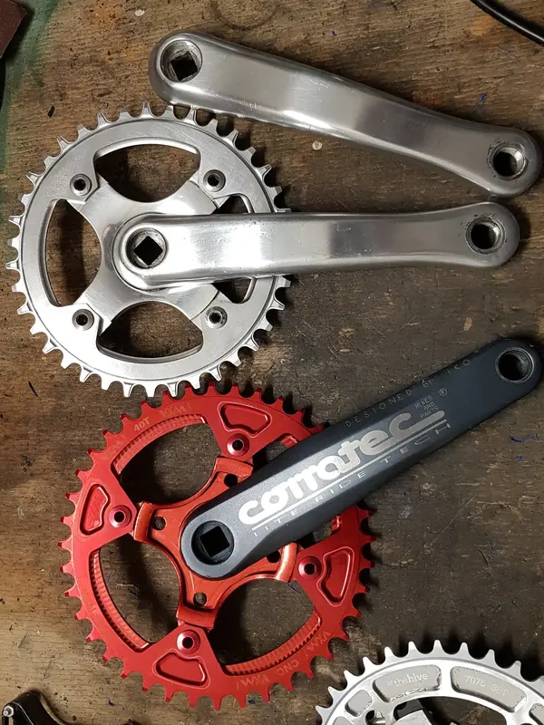

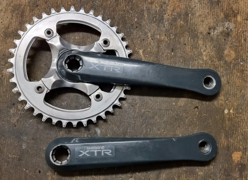

That's the reason why I'm trying if I want to have a 1xX set-up (personally i do like this a lot for bikes I'm using as daily driver) also for my classic bikes to organize a 4 arm cranks but with square bottom bracket like Ritchey, Bontrager, Corratec, XTR950 (with XT spider hack) or STX RC (4 arm spider variant)

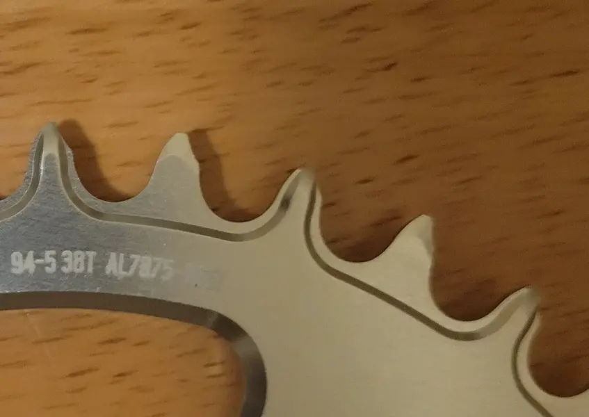

Just got some samples today.
7075 t651
In My case. I'm using race face lp's. I like the looks. It works and i wanted to keep using it. All the modern stuff needed me to change my set up. Very expensive. This us my simple solution. I hope to have supply this fall
