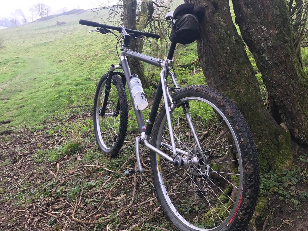

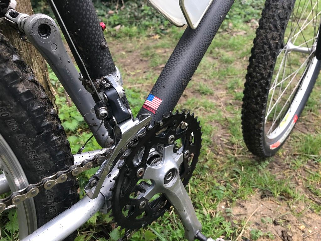

Ok here is the first build up and test ride :D
Rides well , quite compliant and a good climber too .
Not as harsh as the alloy Cinder Cone I have been using lately, I think with some better tyres I might use the rigid fork on it too :D
Anyway here are a couple of pics .
If I'm not mistaken that is a 93 or 94 trek 8700. The 8700 shx was available in 95 with a judy xc. The regular 8700's were ridged and shx denotes a front shock. Beautiful build. I built a yellow 1996 8000 shx last summer. I've had a few treks over the years and they are great to ride.
