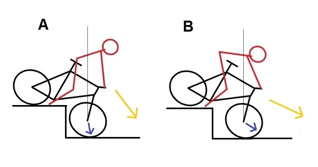

I'm definitely no expert rider and I used to be Captain OvertheBars even on a modern Carbon, 140mm Full suss all mountain bike, I bought the shortest stem possible, but still no better. So I went and had some lessons. It made all the difference.
To do any drop off you have to push you hips back (off the saddle) and push forward with the arms.
This is how it was explained to me.
In figure A you can see the the rider's torso is ahead of the hub of the front wheel, this causes the wheel to dig into the ground (blue arrow) and the direction of the force to be towards the ground. This results in the front wheel stalling and the momentum of the bike and rider carries on "over the bars."
In figure B, as the rider reaches the lip of the drop off the rider pushes their hips back and arms forward on the bars. The cause the front wheel to go further over the drop off, and the riders weight is now behind the front hub. The force on the front wheel is now more forward than down (blue arrow) as is the direction of the force of the bike and rider. So instead of digging in the front wheel goes forward and the back wheel follows in the normal manner.
Bigger wheels will soften the angle of smaller dropoffs but on anything bigger you will still have the same problem, but with further to fall ;-)
Save the money of a new bike and spend it on a lesson or two. It doesn't matter how long you've been riding, having somebody watch and critique your riding style will always be helpful. Well worth it. I can now do Alpine Black DH runs on a 120mm hard tail without any OTB moments.

I always think of it as how I ride, keep the body in the same position and let the bike move under you, that's if you are dropping the wheel down the slope. And just don't panic or use brakes till you are off these small drops.
Let it flow.
You'll see in the picture above the body look much like a flat riding style just with the bike now in a different position and ar!ms extended more.

Stiff_Orange":353pd5vu said:
It's nothing to do with wheel size, height, bike size. It's all about body position.
