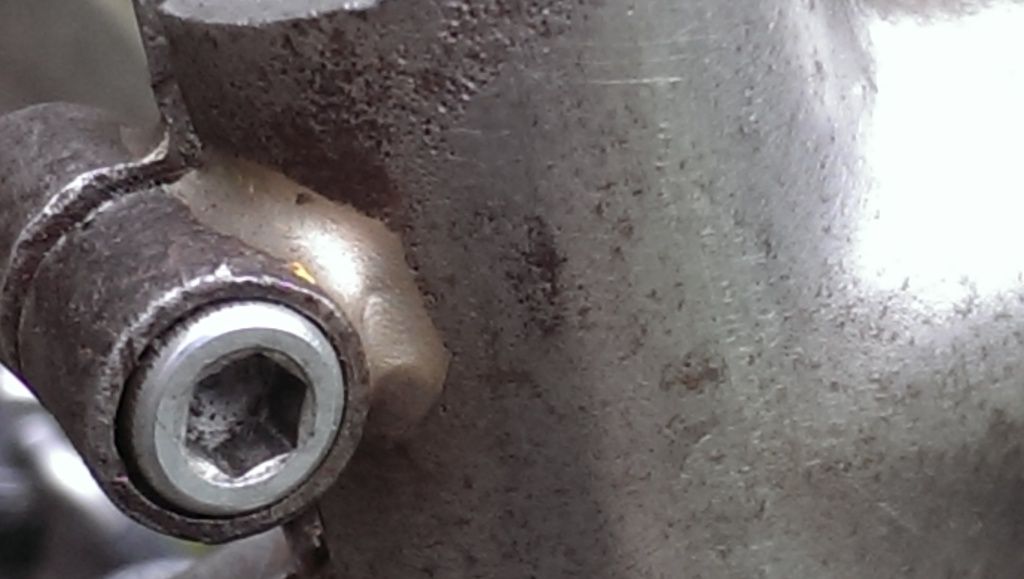

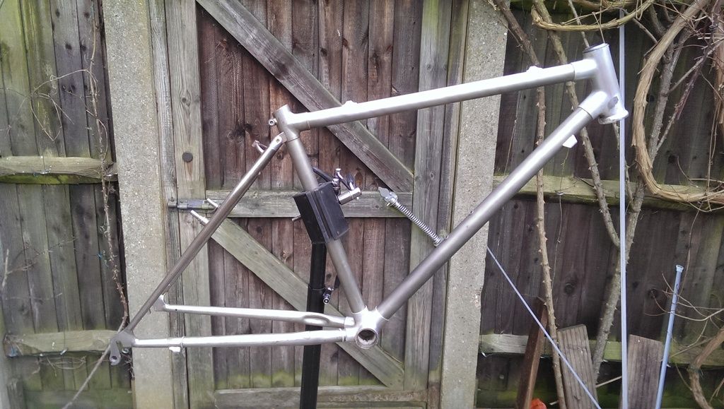

I picked this frame up at the weekend, (thanks Rob), and had intended to get it powder coated and generally smartened up. However when I saw it I fell in love with the raw finish,
particularly the brass fillet welds on the seat stays.
So, I've run a green scourer over it, and I'm going to try linseed oil on it. (Thanks for the suggestion Paul.)
For the moment, I intend to keep it rigid and use it as my daily work bike.

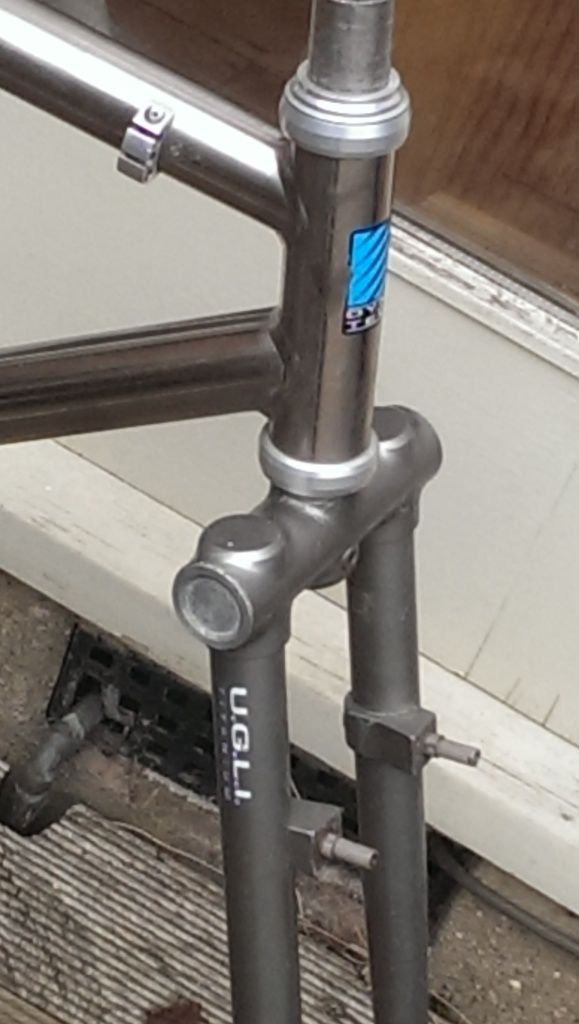

I'm undecided between pace RC30s and a pair of titanium UGLI forks.
if I go with the UGLIs, I'm kind of tempted to strip them to match the rest of the frame.
Please do comment, RC30 or UGLI forks, if UGLIs stripped or painted?
UGLIs at present:

UGLIs are indeed ugly ;) I would go for the lighter of those 2 forks, if that is UGLI than paint it in the same color as frame or color that goes well with the one you chose for the frame.

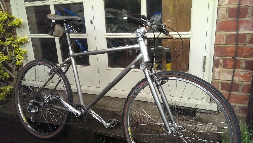

Been riding my MT4 to work for the last couple of days.
It's a cracking ride but there are a few things I'm going to change.
Flat bars are going to be replaced by some risers.
UGLI forks are cracked so RC30s are going on.
I ended up thinking the hope silver stem and headset were too much silver so I'm going to try a Thomson or Syncros stem in black
RS7 and UNO are temporary till I can fit the RS2s and a front mech.

Ah it is shame about UGLIs...

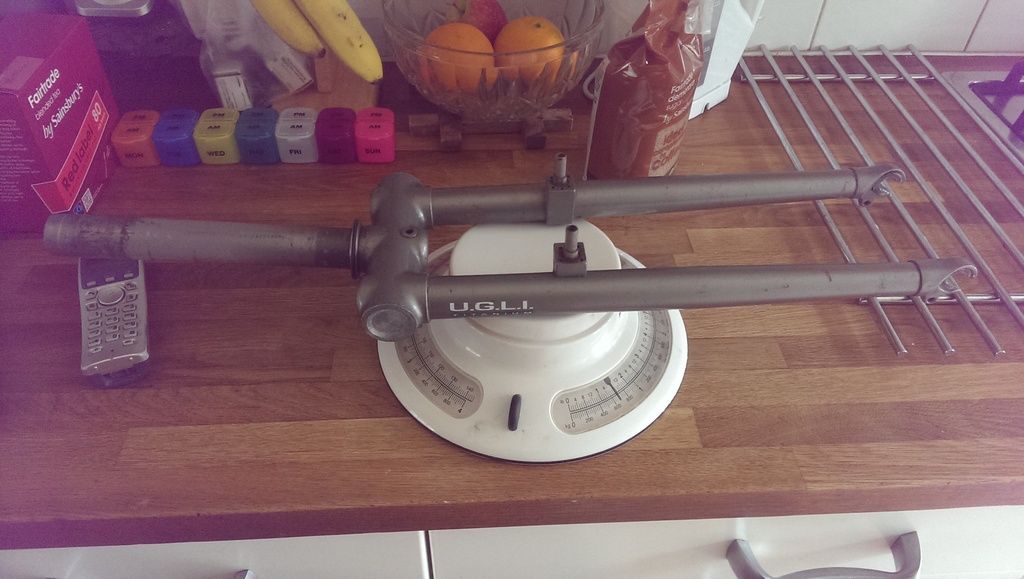

I just want to remind you to weight it after you finish it. ;)
