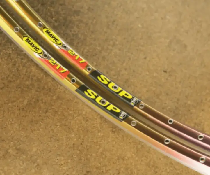

Don't know if anyone can help me on this?, Ive just found my ultimate rims a set of 26" Mavic 217 SUP Sunset rims New Old Stock, and I need to purchase the correct length spokes for the hubs I'm planning on using.
Rear rim has 36 Holes and will use either a Shimano Deore XT 7 speed, Hub M730 or a Deore XTR M900
Front Rim has 32 Holes and will use either a Shimano Deore XT Hub M730 or a Deore XTR M900
was wondering if anyone can help me with what length spokes I would need?
